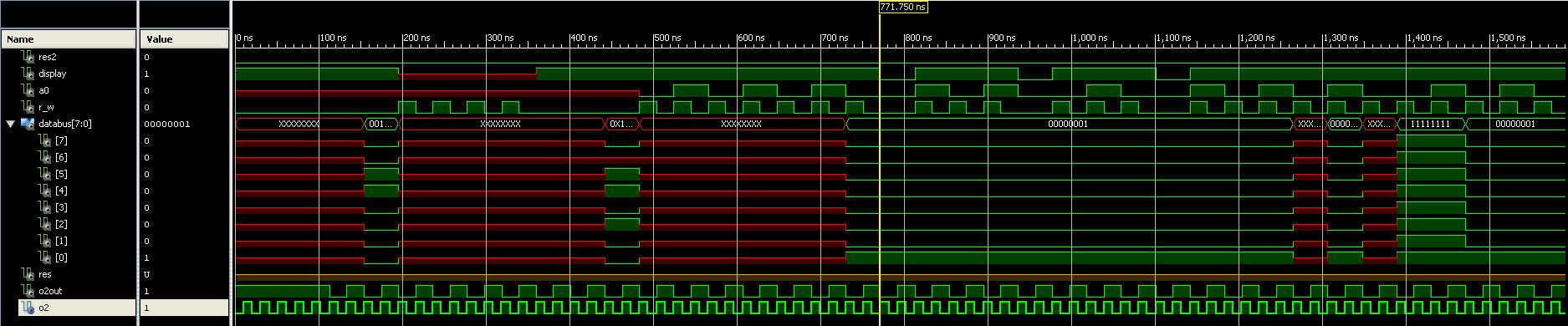

Today I made a little progress and was able to get ISim to run a simulation. Instead of writing a testbench in a HDL, I was able to force NMI inactive, active reset for a initial time of 5000ps, and force a 20.58ns clock for O2. Below is a pic from ISim with system successfully running @24MHz. One thing I don't understand is the display (chip select) signal goes low 3 times and that's it? I ran the sim for a full 8sec and it never again goes low, even though the display in real life is constantly clearing the display with incrementally changing colors.
   LDA #$01   ;software reset
   STA dcom
   STA dcom
   STA dcom
   LDX #$ff   ;delay
a   DEX
   BNE a
   LDA #$e0   ;start PLL
   STA dcom
   LDA #$01
   STA ddat
   LDX #$ff   ;delay
b   DEX
   BNE b
   LDA #$e0   ;lock PLL
   STA dcom
   LDA #$03
   STA ddat
   LDA #$b0   ;set LCD mode, 640x480
   STA dcom
   LDA #$0c
   STA ddat
   LDA #$80
   STA ddat
   LDA #$02
   STA ddat
   LDA #$7f
   STA ddat
   LDA #$01
   STA ddat
   LDA #$df
   STA ddat
   STZ ddat
   LDA #$f0   ;set interface format:8-bit
   STA dcom
   LDA #$00
   STA ddat
   LDA #$3a   ;set RGB format, 18 bits per pixel
   STA dcom
   LDA #$60
   STA ddat
   LDA #$e6   ;set pixel clock
   STA dcom
   LDA #$04
   STA ddat
   LDA #$ff
   STA ddat
   LDA #$ff
   STA ddat
   LDA #$b4   ;set Horizontal Period
   STA dcom
   LDA #$02
   STA ddat
   LDA #$f8
   STA ddat
   STZ ddat
   LDA #$44
   STA ddat
   LDA #$0f
   STA ddat
   STZ ddat
   STZ ddat
   STZ ddat
   LDA #$b6   ;set Vertical Period
   STA dcom
   LDA #$01
   STA ddat
   LDA #$f8
   STA ddat
   STZ ddat
   LDA #$13
   STA ddat
   LDA #$07
   STA ddat
   STZ ddat
   STZ ddat

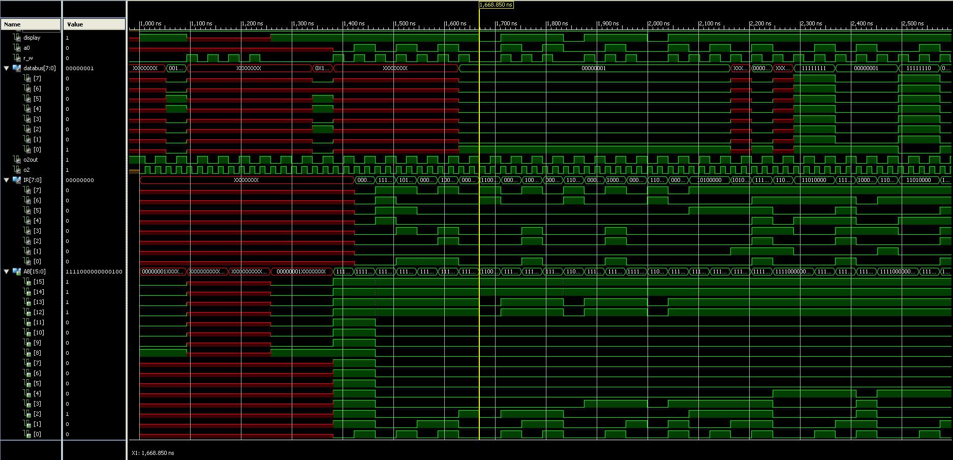

What you can do is add the signals for the internal PC, and A, X, Y registers. That way you can see what the CPU core is doing, and if that matches what you expect.
 Post subject:
PostPosted: Wed Mar 09, 2011 10:21 am
Joined: Thu Jul 22, 2004 11:46 am
Posts: 43
Location: Sweden
Exactly, and possibly the IR as well, cuz I don't get what the data bus is doing. I can't see an instruction fetches, or are they strictly internal ?
 Post subject:
PostPosted: Wed Mar 09, 2011 5:38 pm
@PontusO. I will post another pic with IR and address bus. O2 feeds a divider. O2Out is what the display sees. An inverted O2Out is what the internal core/RAMs/ROM sees as per this schematic.
I should have included the address lines as well. Looking at them reminded me of the fact that I had increased those 2 delays from what I had posted above because I had increased the speed of O2 to 24MHz from much slower speeds. I think what I thought was 8sec's was maybe more like .8sec's...Turns out the display still init's ok with those short delays @24MHz.
Looking at A0, Display, and R/W with respect to O2out, it is in spec with the SSD1963 datasheet (Fig.13-2 on pg. 78.), even at 48MHz.
At this point I'm thinking the values I have for initializing the display are not up to speed. I would think, for example, the pixel clock would have to be faster that the O2 speed? I suspect this because right now the pixel clock is set for 33MHz.
I'm focusing on 2 registers, $E2 (Set PLL frequency, Pg. 72) and $E6 (Set Pixel clock, Pg.74).
Any comments or suggestions? TIA

Looks like you're happily in that tight loop running DEX. Is it worth loading a smaller value than FF so you can see what happens when you hit zero?

Yep, that is definitely what's going on there. Is it possible to switch to hex notation on the signals ?It would make it easier to study the execution flow.

@BigEd. I should have thought of that earlier. Somewhere in the datasheet I remember reading that a delay was necessary only durint INIT'ing the PLL/timing registers. The delay values spec'd were different. One was in the uS range, the other delay was even longer IIRC. Anyway this may give me a clue if I see something similar as to what I am seeing now attempting 48MHz. Most of the time I do see an incorrect display initialization, although it is repeatable most of the time, and data is very clearly passing to the display albeit incorrectly. Sometimes I see color data, but all the sync's were wrong. This tells me Arlet's core is functioning fine at 48MHz... When I have a few hours, I will test those display delay settings to destruction, i.e. a non working display @24MHz. Just FYI at 24MHz, the screen is clearing at maybe 3-4 frames a sec at 640x480x3x8bits.

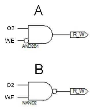

Another issue: While trying to conform all FPGA outputs to the display for active low outputs, I am puzzled about the following: The "A" R_W circuit works. For some reason, the "B" R_W circuit doesn't. Why would this be so? It's right in the middle of the current schematic.
 Post subject:
PostPosted: Sat Mar 12, 2011 9:20 am
Posts: 10837
Hi EE
on the subject of the delay loop, I was suggesting you shorten it (dramatically) for the purposes of seeing more on the simulation - you might need to keep it the same for the real circuit. (I think you said that the simulation never did any more writes after the first three)
on the subject of R/W, one of your gates will invert the sense of O2, and the other one doesn't - so that will make a big difference as to which phase the output will be active.

PostPosted: Sat Mar 12, 2011 12:23 pm
Hi EE
on the subject of the delay loop, I was suggesting you shorten it (dramatically) for the purposes of seeing more on the simulation - you might need to keep it the same for the real circuit. (I think you said that the simulation never did any more writes after the first three)...
I am only doing a screen capture, so without it being too crammed and unreadable, only small portions of code can be seen. Would be nice if I could have it scroll horizontally. If someone is aware of a utility I could use, I'll try it in the future...
But after I realized I had extended the delays, then brought them back down to what I had shown in code and reran ISim, the display signal is going low and being written when it's supposed to, i.e. when $C000,$C001 are on the address bus. Sorry for not explicitly saying that before.
About the N/AND gates. I see what you're saying (I was over-simplifing things and thinking of truth table only) and it gives me an idea to use the NAND circuit for R/W and take out the inverter going to the TFT O2. Also, I'm going to try to change the slew rate from slow to fast and retry 48MHz. Will have to wait till after work...
