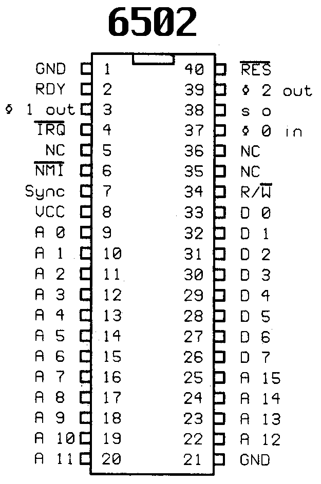

I ordered a couple of Rockwell 6502s from UTSource too and they looked as suspicious as a very suspicious thing looks; two different DIP packages with identical etchings. Long story short I've been trying to work out how to test them with minimal effort, like, not even putting them in a breadboard effort.
And as I've been testing all the other ICs I bought with the TL866 II I figured I could probably use it for the 6502 too. And it turns out I can. I've attached the R6502.lgc file to this post and it can be imported into XGPro Logic Tester.

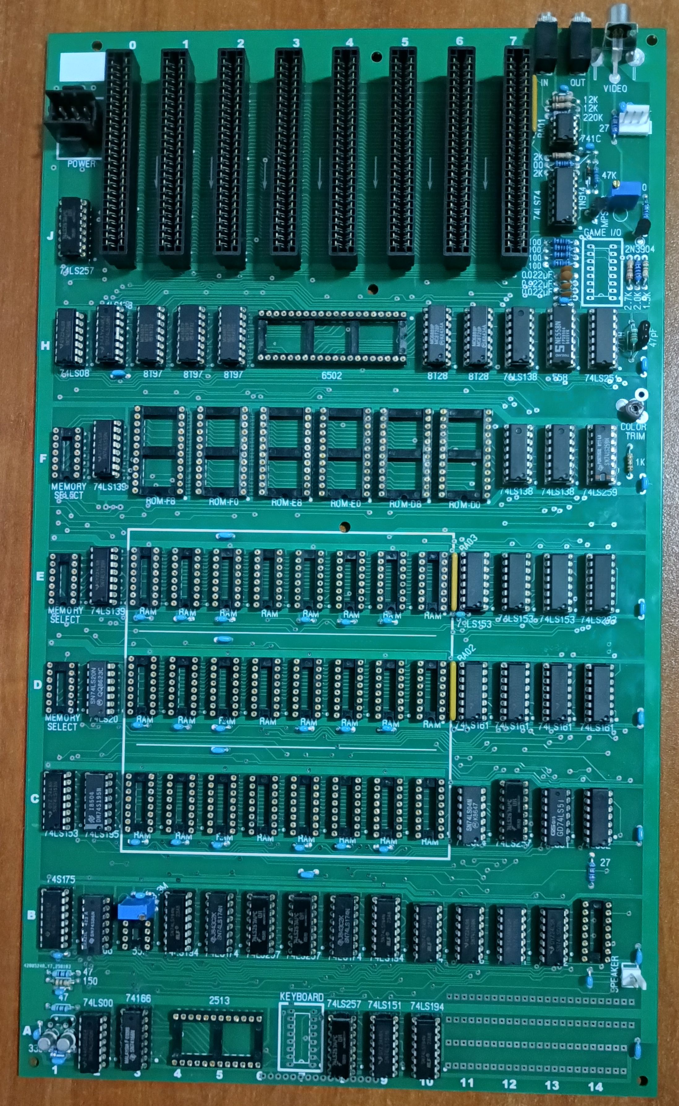

And, just for pictures sake:The fully soldered but only partially populated Apple II rev0 board I'm making.
