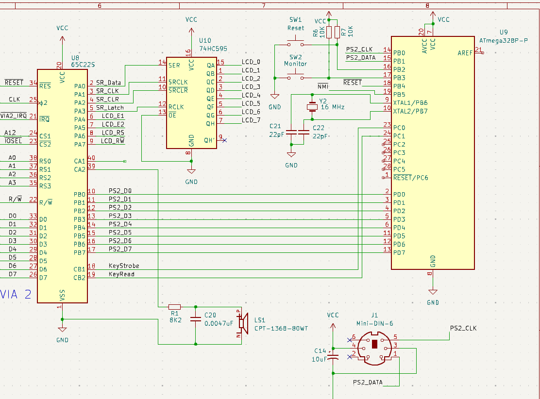

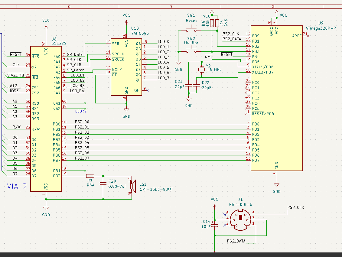

From a VIA.
I plan on putting a shift register between the VIA and the ATMega which uses four pins of Port A. Then the other four pins will control the LCD registers, etc.
As for the PS/2, just straight 8 pins from the ATMega.
Attached is the unfinished schematic so far.

Seven bits of keyboard data and one 'ready' flag?

Sorry, I was unclear: you have eight bits representing the state of the keyboard in some fashion, but no obvious way to say when a key is ready to be handled.
The classic way to handle that is to use one line to interrupt the processor, and for the processor to reset that interrupt bit. But I don't see anything to indicate that in (admittedly incomplete) drawing. So I wondered if you were using just seven bits of data - which would let you have all the ascii set, but give some difficulty with e.g. the cursor keys, F keys, and handling control and alt combinations - and somehow using the remaining bit to flag that a key is waiting.
Or perhaps you're going to let the 6502 handle the key combinations and just pass the real-time key values - though that requires all eight bits to collect the full set. So you still have to find some way to tell the processor that there's something to handle, with the added complication that only about a third of the key codes are equivalent to a key being pressed, so the processor might be a bit busy.
To be honest, I'd decode in the AVR, probably buffer the output, and encode the keys I care about into eight bits (this is what I am doing with my Pi Pico vga chip interface) and find some way to generate an interrupt (though you'll still need some way to clear that interrupt before the next keystroke).

Posts: 1488
cbmeeks wrote:
From a VIA.
OK. Great!
But hoes does the 6502 know when there is a character to read and how does the AVR know you're read it?
If I may suggest a change...
Move the speaker over to CA2 then the whole of port B is dedicated to the AVR interface.
Use the CB1 input as a strobe from an otherwise unused output on the AVR, so AVR decodes keypress (as an 8-bit ASCII, encode the keys like arrows, pgUp, etc. how you like) puts the 8-bit data on the output port, toggles CB1...
The 6502 gets an interrupt, reads the data, sets CB2 - connected to another spare pin which means the AVR then knows it's been read, so can present the next keypress.
This is basic VIA port read handshaking I think... (Although I recall that both ports work slightly differently - I'd need to check the data sheet)
Prudence might also suggest a flyback diode over the speaker...

Posts: 1250
Oh, I see what you mean. Yeah, I completely missed that!
Hmm, I will have to think about that as I have already used up all my pins on that VIA. (not totally sure how CA(B)1/2 work).
And yeah, I was going to have the AVR decode the key strokes and send the bytes over so the 6502 only has to read the byte. Or, multiple bytes actually like the F0 (or whatever it is) that indicates the stream is done.
Any suggestions? Thing is, I have two VIA's and a UART and I wanted the option of choosing which one connects to the /IRQ. And I really don't want to poll the AVR.
Going to have to think about this...

PostPosted: Fri Nov 01, 2024 3:49 pm
Posts: 1250
Something like this?
I'm struggling with how the /IRQ is going to work with the three devices. I can eliminate one of the VIA's from the /IRQ and that would leave a UART and VIA (PS/2, LCD). It would be really nice if I could use the PS/2 and get serial interrupts together.
