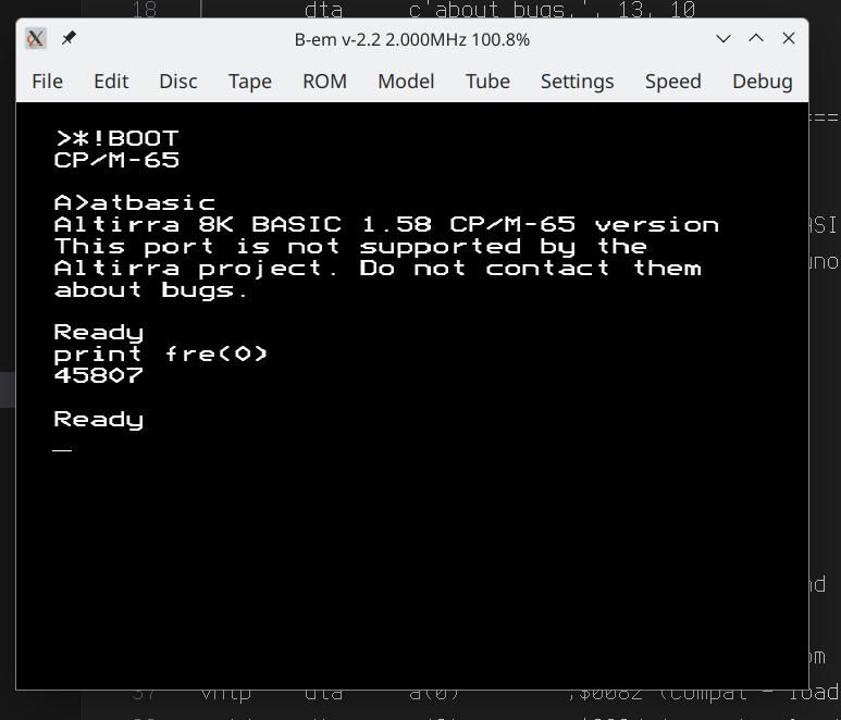

I've done the Altirra BASIC port (see picture). It's now about 11kB, but that does include Avery Lee's mathpack clone and the CP/M I/O translation layer. It's not the greatest BASIC, but it's there and that's better than no BASIC.
I'm going to have to take a break for other projects but I intend to come back to FastBasic. It's definitely something I'd like to have...
