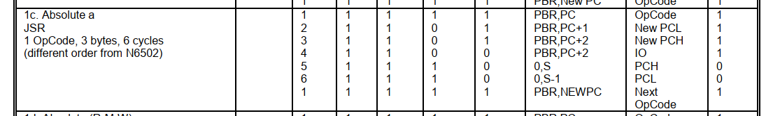

Interestingly the 65C816 doesn't seem to have this same behaviour (if I've read the datasheet correctly).
It reads both the new program counter low and high bytes before it pushes them onto the stack. Even in emulation mode.
At least I really hope that's what it does because that's how I've implemented it in my emulator. I damaged my '816 board so I can't quickly test this but I'd be interested to know if anyone else does.
Cheers!
Andrew

I believe on the 65816 there are a couple of forms of JSR that might exhibit this behaviour:
JSL (opcode 0x22)
     // JSL: <opcode> <op1> <op2> <write pbr> <read dummy> <op3> <write pch> <write pcl>
JSR (IND16, X) (opcode 0xFC)
      // <opcode> <op1> <write pch> <write pcl> <op2> <internal> <read new pcl> <read new pch>
These both needed "special casing" in the 6502 Decoder.
Dave
PostPosted: Fri Jun 30, 2023 8:55 pm
Posts: 10938
Ah, that's a good point Dave, any core which works as a 6502 with the decoder must be doing the right thing.
