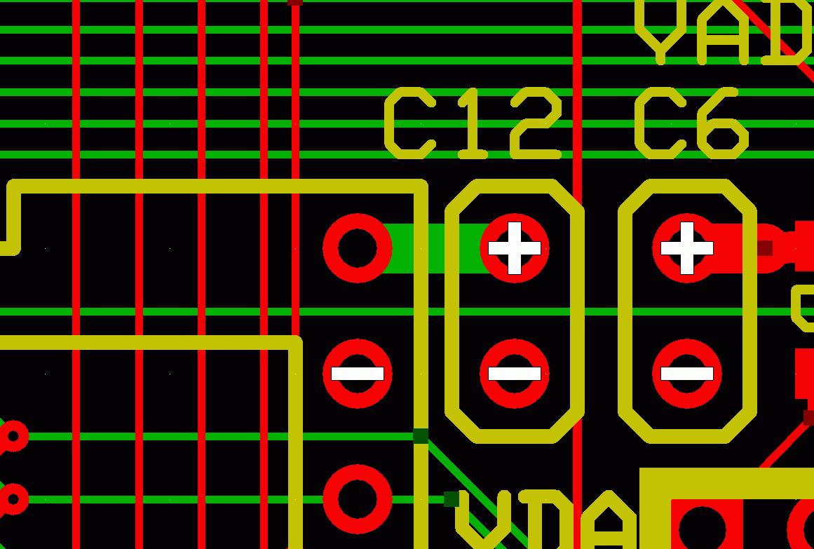

In my designs, I don’t directly connect the device’s VCC pin to the power plane. Instead I connect it via a short trace to the device’s bypass capacitor, with the latter’s through-hole being the bond to the power plane. This arrangement, promoted by Dr. Howard Johnson, makes the capacitor more effective at preventing switching noise from getting into the power plane. See below illustration for an example.
File comment: Vcc Connection Example
Note how capacitor C12 is connected to the part it is bypassing (a ROM socket, in this case) and how the path from the socket to the internal power plane is via the capacitor’s pad.

Do put a Vcc bypass cap. at each Vcc pin, with the electrical path from the pin through the cap. to ground as short as you can.  Again for hand-assembling, you can put the via in the pad, to shorten the path and reduce the inductance.
Excellent reminder BDD. I made mine just like that as well. Make sense to follow those who know better than I do.

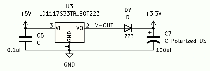

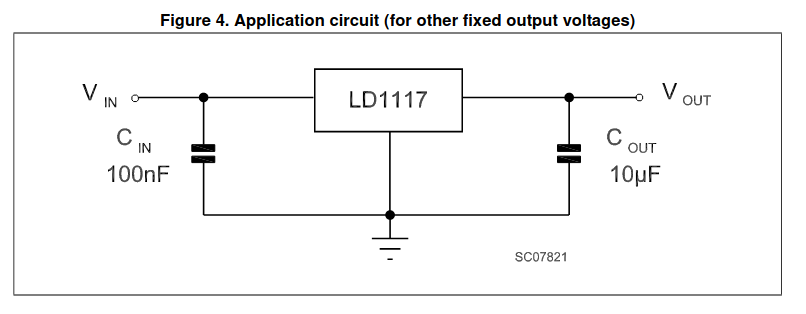

Some additional questions:
I am putting both +5V input and +3V3 input options on the connector. Eventually I foresee my (future) 6502 running at 3V3, so I want to be able to bypass the voltage converter. But having that option permanently available would be nice. Could I just leave that +5V input floating, and just directly connect 3V3 to the output of the LM1117-3.3 instead?
Also, coming out of the LM1117 it goes directly to my 100uF cap. From there I use a via to connect it to the 3V3 inner plane. That seems a bit like a bottle-neck. Could ALL of the device's power go through a single via, and still be ok?
Thank you all very much for the advice and help!
Chad

sburrow wrote:
I went and looked up the L78L33, the main problem I see that it says the minimum voltage would be 5.3V or something, which is not what I'm expecting. Just 5.0V or maybe even a little less. That worries me, so I went searching some more. I found my old friend the LM1117-3.3, which I had used on a project years ago with success. Well, they also have an LD1117-3.3, and it's in a SOT-223 package which is definitely bigger than the SOT-23. Seems easy to work with, plentiful to get, and cheap. So that's my new converter for now. Thank you for that advice Sam!
Indeed, if you are trying to go from 5 to 3.3 you need an LDO or at least a quasi-LDO regulator. Your LM1117-3.3 looks like it might be reasonable for your application, but do read the datasheet carefully about the caps that it needs. The TI datasheet says the output cap needs an ESR between 0.3 and 22 Ohms and at least 10uF, which rules out a ceramic 10uF cap (ESR will be to low). They suggest tantalum caps for input and output.
Some regulators don't seem to mind this and others really don't like it - especially if your "provided" 3.3V is a little higher than what the regulator would like it to be. Many datasheets don't describe this scenario and I happen to know from "experience" which ones I commonly use that *don't* like that scenario. Section 8.4.1 in the TI datasheet for the LM1117 seems to say that you normally don't need a protection diode across the regulator, but they do show where it would go and describe when you might need to add it.
Most of the regulators I use will not pull *down* at their output, meaning if you accidentally input a higher voltage directly to the regulator's output node, the regulator will not hold it down to 3.3V and you will likely need to replace the regulator and whatever else in the circuit doesn't like higher voltages.

Good reasons to just go with the through-hole socket for now. 1) I am not ready for simply soldering my ROM directly to the board, and 2) I am not yet experienced enough to do *everything* SMT. Good compromise, thank you Bill.
Attached pictures are from my schematics, and the recommended from the datasheet. Could I add a diode in there, forcing any external 3V3 to not go back into the LD1117? Also, if the LD1117 output is grounded because of a floating V_in, this would also prevent problems there as well, right? If so, what type of diode would work? I am very unfamiliar with power regulation, typically I just use 5V for everything and walk away.

PostPosted: Mon Jun 19, 2023 1:28 am
Posts: 249
Putting a diode inline with the output will just drop the output 0.7ish volts, and the output cap should be right at the output, so that configuration isn't going to work well.
First of all, there is nothing tricky about 3.3V except that it's not 5. You should be doing all the things you did before to get good regulated 5V, but just with 3.3V parts.
Looking at the part number you've selected and the datasheet diagram, it looks like you've selected an ST part number. ST has a reputation for making good copies of other manufacturer's parts and offering them at a less expensive price point, so as a hobbyist you'll see them a lot (because of the lower price) and they are a good choice for cost savings. Check out the difference in price between a MAX232 IC and an ST232 IC. What ST isn't so good at, in my opinion, is datasheets. Because they are trying to be a second source, they are trying to sell to people who have already designed in a more expensive part and are now either trying to reduce BOM cost or find an alternate part if the original supplier doesn't have any stock available to sell at the moment. This means that their datasheets don't need to be as detailed, and they are often just enough to get an engineer to say "looks good enough based on the specs".
If it's not an ST specific part (ST doesn't just copy - they make their own stuff too), then I'll recommend looking at other datasheets. TI tends to have more how and why application information in them. Specifically, the ST datasheet doesn't even mention anything about the ESR of the output capacitor, while it's spelled out (or in one case has a footnote) in several of the other manufacturers I quickly checked.
To make it slightly more confusing, not all of these clones of other manufacturer's parts are exactly identical. The Diodes AZ1117C-3.3, for example, is compatible with low ESR caps and you could use a ceramic 10uF on the output (but it does still need an ESR less than 20 Ohms and a tantalum would work fine here as well).
Even if you are using the clone parts, it's worth checking out the other data sheets. If you design using the Linear or TI parameters, then any of the others will, indeed, be a drop in replacement. You should check out the Linear or TI datasheet (they are essentially the same as TI bought Linear in 2016). These datasheets also show the protection diode and how it is installed, but it's likely you don't need it unless you have a very large (eg. 1000uF or more) output cap.
PostPosted: Mon Jun 19, 2023 5:21 am
Online
Posts: 8453
The protection diode normally goes across the regulator, from input to output, with the anode toward the output, ie, toward the load, so it's reverse-biased in normal operation, but you won't damage the regulator if you short the input while the output has a big capacitor on it holding the voltage up.
LDO (low dropout) linear regulators are the ones that are pretty picky about capacitor values and ESRs, and if you don't get them in the acceptable ranges, the regulator will oscillate.  Non-LDO ones don't have this problem, but they usually need the input to be at least around 1.7V above the output to actually regulate.  If you use one of these to bring 5V down to 3.3V, you'll probably be pretty close to 3.3V, although I would look at the curves in the data sheet and probably make my own measurements before depending on it.  The output won't get high enough to damage your 3.3V circuits though.

PostPosted: Mon Jun 19, 2023 11:37 am
Posts: 707
Ah! I never think of these things. Yes, thank you for that.
Of course I knew the first letters are from the manufacturer... but apparently I forgot that here! I went and looked up the TI version, TLV1117LV33, and yep that datasheet has a lot more information. Thank you for telling me about this.
An oscillating power supply is not good for sure. I will follow what they say exactly.
That output current is the one to watch because it is almost *never* available at the maximum supply voltage - and in some cases it is only available when the supply voltage is very close to the minimum.
Does it come back to P = V * I, the more voltage the less current?
Things get hot quickly.
I really don't want heat. For all of the projects I've done, if anything is above body temperature then something is very very wrong.
Ok, great info here guys, thank you so much.
First, I'm going to use the TI part. It's not expensive, and it's an easy configuration. Second, I'm going to set up some solder jumpers or something to allow for outside 3V3 input, instead of assuming that the regulator will be ok with it. It's not like I'll be changing the power supply much if at all.
Well, I sure have learned a lot here. Thank you again, I appreciate all of the help and personal experiences :) I'll be giving updates and results as I have them, but at this time I'm just waiting for stuff to arrive in the mail to continue testing.
