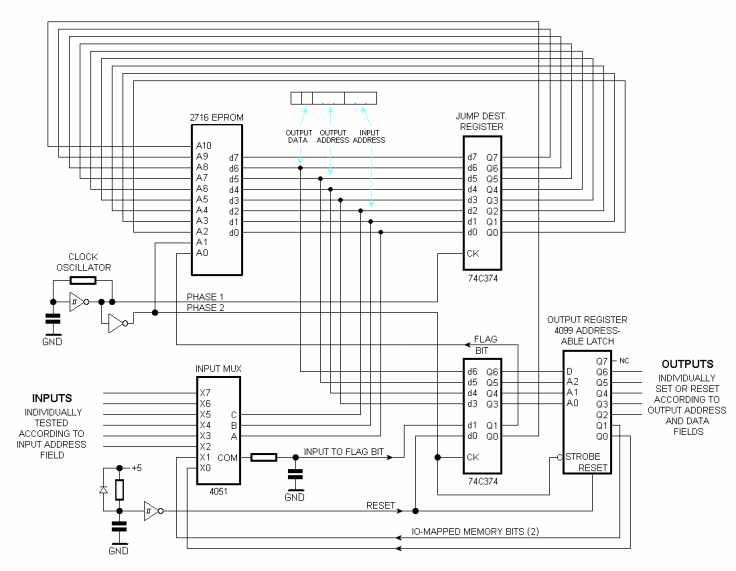

Back in the 20th Century I designed and deployed a discrete-TTL machine that had no NOP per se. But in order to fill that need, certain operand encodings (not opcode encodings) were reserved. A similar idea might be helpful for the "Simplest subset of 6502" machine. For example, sta absolute is a NOP if the operand specifies a ROM address. Better candidates can probably be contrived.
OT: for the curious, see One-bit Computing at 60 Hertz. The machine is a bituva mutant, because there actually aren't any opcode encodings. There're no need for an opcode because the machine only has one (somewhat VLIW-ish) instruction! :shock: :lol:

Believe me, I have scoured your website (and its hidden depths) in great detail and with fascination in the past, this included. I have always found the Diablo CPU pages particularly interesting.
