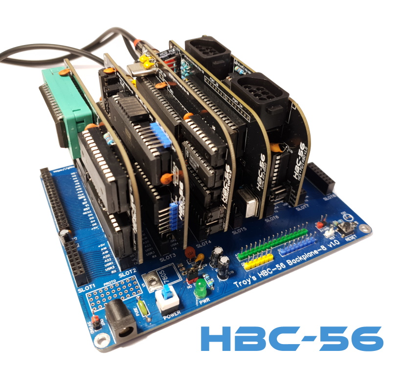

Rather than start a new thread for each update on this project, I've decided to create a single thread and update it as required. This is that thread.
Background
This is my second homebrew project after first completing a Ben Eater inspired SAP-1ish on a breadboard. Dipped my toe in 65C02 assembly working on some Commander X16 projects, so decided to do a 65C02 next. Loved the idea of a backplane where I can easily add/replace components of the build at will. I also have a soft spot for the TMS9918A having grown up with a TI-99/4A. So that was my starting point. (Yes, I'm quite a newbie at this - but have a very extensive background in software).
I started out building the project on breadboards, but then designed a backplane and custom proto card to start the build proper. I started out with a graphics LCD:
Then built the TMS9918A card and added support for a NES controller:
It was around this point I started working on the emulator. For this, I wrote my own 65C02 and TMS9918A emulator libraries and built both a desktop and web-based version. You can try the latest web version here (requires keyboard): https://visrealm.github.io/hbc-56/emulator/wasm
Not long after that, I was contacted by PCBWay who were keen to supply me with PCBs in return for mentioning them (nothing more than that). This surprised me as my project / YouTube, etc. has very few followers, but I decided to go ahead anyway. This gave me the perfect opportunity to design custom PCBs to replace the old hand-wired ones.
The brings me to the present day where I've started building out some of these new cards and documenting the process in video form. It's not all smooth-sailing and you might get something out of these. If you're interested in TMS9918A development, I'm planning to do some videos on that specifically soon (probably after the card build series).

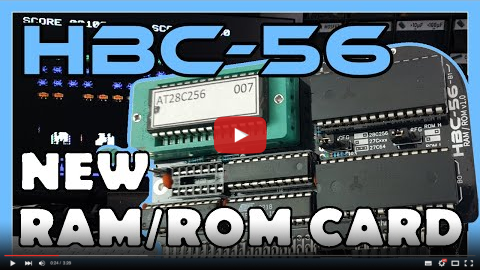

The new RAM/ROM card. It contains 64KB RAM + 32KB ROM with runtime-configurable selection of RAM or ROM in 4KB pages.

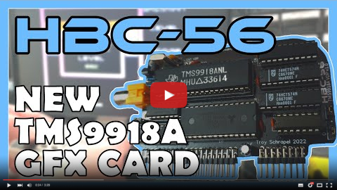

Video covering the schematic, PCB design, assembly and testing of my new TMS9918A display card

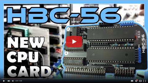

Video covering the schematic, PCB design, assembly, diagnosis, repair and testing of my new 65C02 CPU card

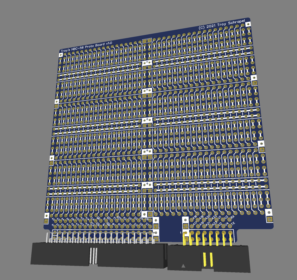

Paganini wrote:
Hey Troy, I think the wiring on the perfboard version looks really nice. Would you mind describing your technique?
I use 30AWG wire-wrapping wire which I think helps a lot. I do 100% of the wiring on the back which makes the front look super-tidy, but adds a bit of difficulty (have to reverse everything in my mind).
I like the wire wrapping wire because I can strip the ends with my fingers and can fit multiple wires in a single hole if need be. Stuff it in, a bit of BluTack to hold it. Flip the board, solder, repeat.
Also, my perfboard cards I custom designed. They have some features which improve tidyness.
  • ICs are intended to straddle the power rails, so power is super convenient.
  • There are traces which can jump each IC section vertically which reduces wiring.
Here's a better look at the PCB layout:
Troy
[My introduction]
Very cool! Am I right in thinking that the horizontal rows of pairs - like this:
OOOO
OOOO
make it so you never have to try and solder a wire to an IC (socket) pin?
That's the idea, yeah. There have been cases where I've still had to do it, but can usually avoid.

The next HBC-56 video is now available. This time covering the new RAM/ROM card. It contains 64KB RAM + 32KB ROM with runtime-configurable selection of RAM or ROM in 4KB pages.

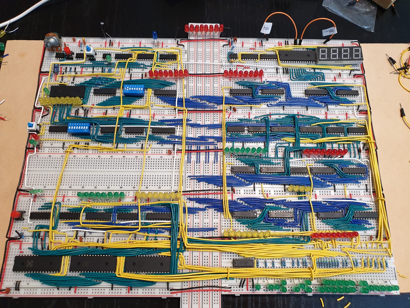

For my breadboard CPU which had a bunch of rows-of-8 LEDs, I made a jig out of a piece of old plastic cutting board by drilling 8 holes in it. Shoved 8 LEDs in the jig and soldered them all together with a piece of solid core wire. Worked quite well (for a breadboard build).
