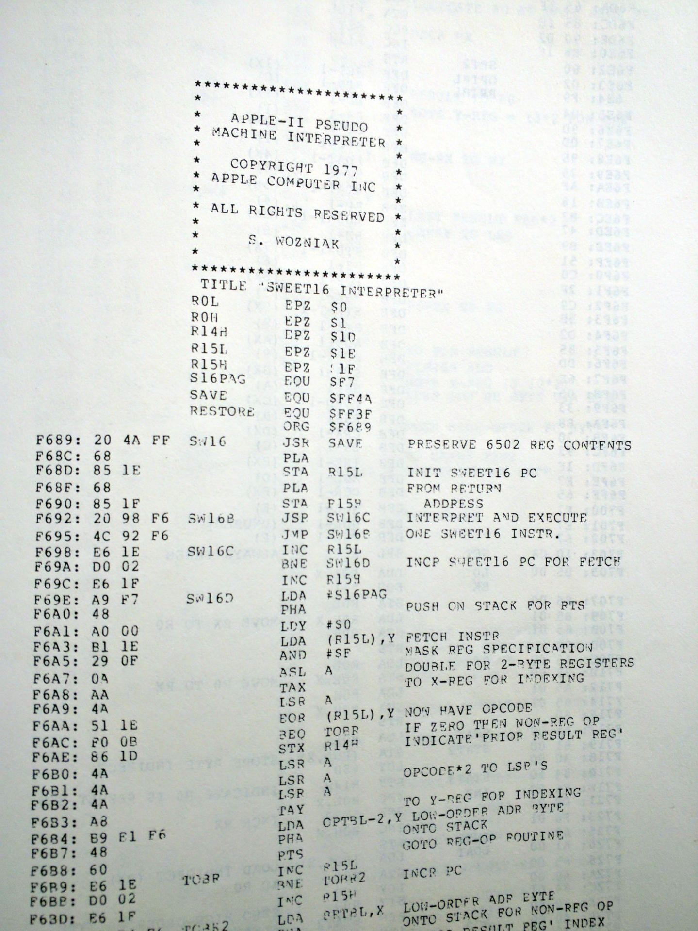

Jmstein7 wrote:
Hi. I've been reading through some of the posts on the site, and I can across this document:
http://www.6502.org/source/interpreters/sweet16.htm which has Woz's Sweet16 code in it. Unfortunately, I don't understand some of the operands and directives. Can anyone help?
That listing is sublty different from the one in the original "Red Book" (1978).
See here:
These are the ones I can't pin down:
AST  32
No clue here
My suspicion is that it's simply to place a line of asterisks in the output listing.
