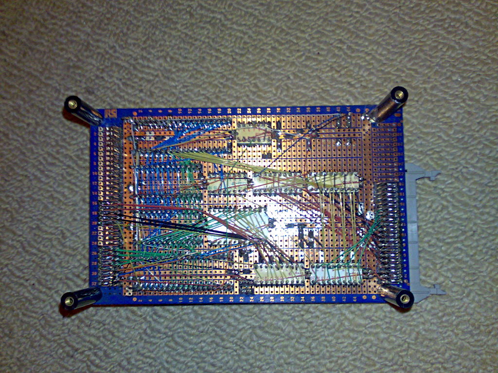

I did a lot of WW back in the 80's. Here is one - it's a 6502 that ran at 2.5Mhz:
However when I came to do my Ruby system I looked at WW again and was quite shocked. The bit of board I used then is still available - for about £45. Then the sockets with square pins are not cheap either, then the wire and finally - back then I used a mains powered 'gun' that did strip and wrap in one go - that is close to £500 now.
And so no wire wrap. I went back to my old favourite, Stripboard when I moved my 65C02 from breadboard.
I'm running at 16Mhz on both Stripboard and double sided PCB, 65C02 and now 65C816.... It's been stable for a very long time now (would have had an uptime of nearly 3 months if I'd not had to power the house down a couple of days ago to change some mains sockets!) and I'm glad I don't have the test kit to tell me it shouldn't be working ...
So I just say "go for it".. Use the technology you're most familiar with. Breadboards are good for a few Mhz and much faster if you take care (e.g. VGA is possible at 25Mhz) but what's a weeks wait for a PCB? Not a lot in my book...
