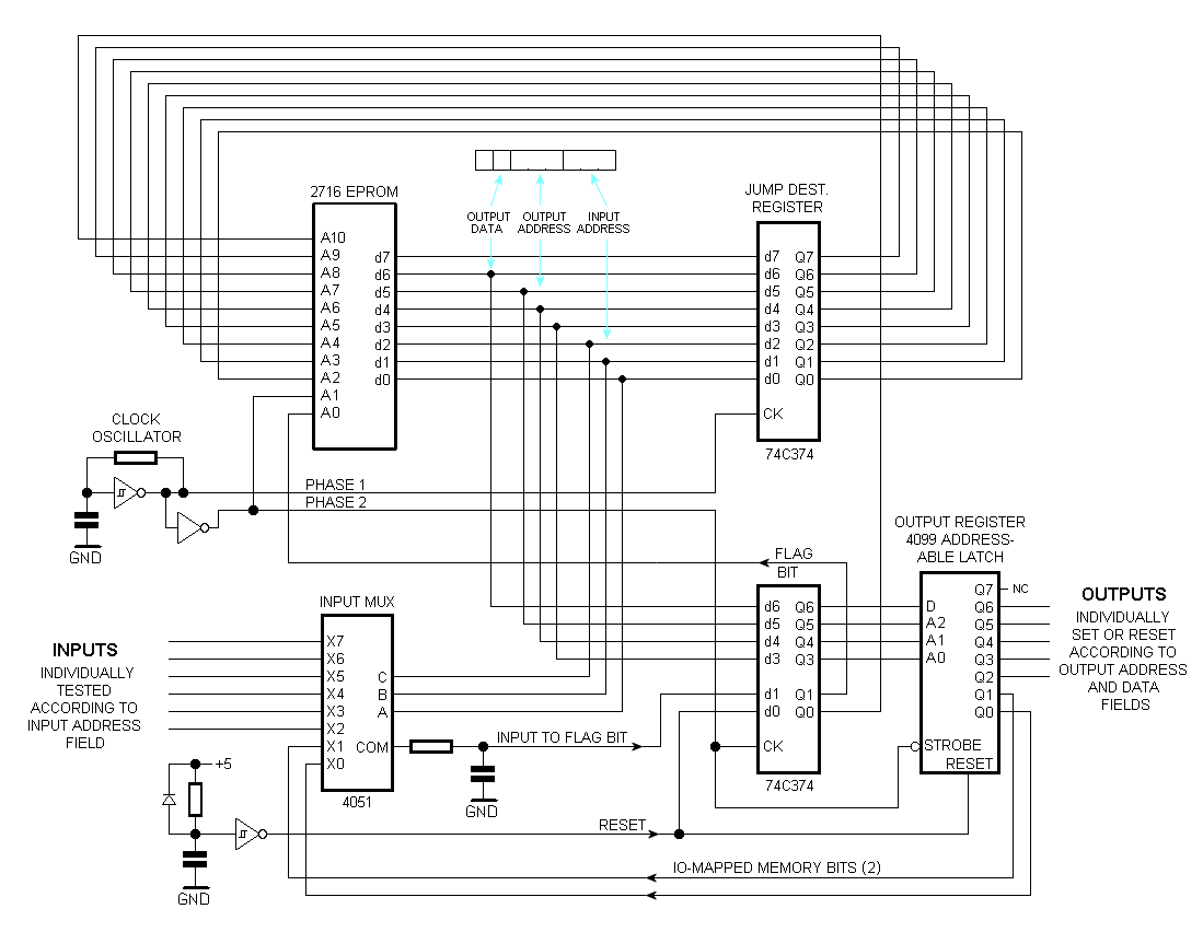

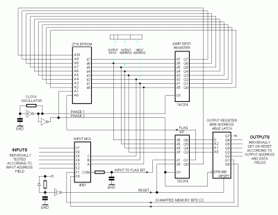

Back in the day I created and applied a design with no ALU at all! :mrgreen: For the curious among you, here are links to its description and to two threads on anycpu.org which mention this and some other unusual processors.
One-bit Computing at 60 Hertz
Some Minimal Instruction Set CPUs
Quirky Chips - from Moto, Signetics and others.
