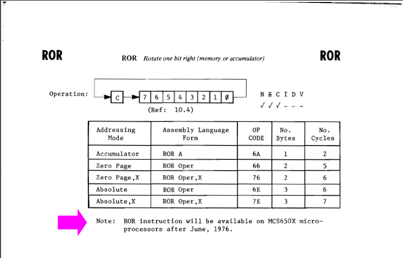

In the video Mensch seemingly attaches a lot of importance to a programming card which doesn't include ROR. And he mentioned Peddle signing off on a spec -- seemingly a key point, in Mensch's view. So, are we to suppose that the sign-off was based on a mere programming card (by which I presume he means a handy, pocket reference)? With all due respect to Mensch, that seems... odd.
Also odd that, as Ed pointed out, ROR almost worked.
ps- FWIW, ROR certainly isn't missing from the MOS Programming Manual, written by Peddle, AIUI, and published Jan 1975. (I'm not saying this supports or refutes what Mensch said in the video.)
