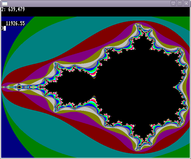

And for no reason other than because... I changed the code slightly to use graphics and ran it on the graphics terminal - at a resolution of 640x480 with 16 colours.
A shade over 3.5 hours later...
the gap at the top is because the graphics terminal is emulating the aspect ratio of the BBC Micro which would be 640 wide by 512 high. (the numbers at the top were just some debugging - I'm sure it would have been faster if I'd not been printing them at every point). the other number is the time in seconds...
I really don't think I'll do that again - however, if nothing else it's a very good test of the system and the image matches the same code run on my desktop PC in RTB Basic.
Ps. It would have been done in half the time if I'd been plotting it symmetrically - which I wasn't...

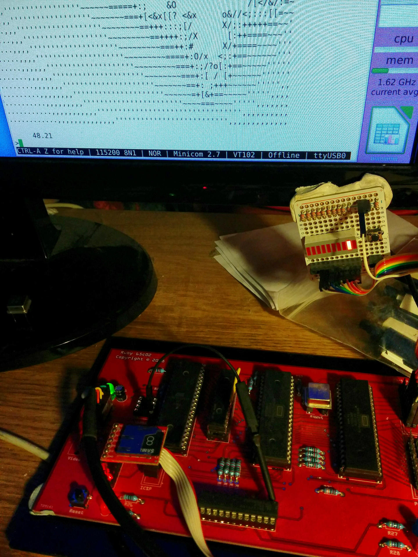

Well - that's (presumably) ehBasic at 16Mhz... My Ruby board will run at 16Mhz, but I only have one 16Mhz can xtal right now, but I'm sure I'd get 96/2 = 48 seconds in BBC Basic on it..
Oh, aright then - you've twisted my arm... ;-)
I moved the 16Mhz can over to the 65C02 side and the clip and black wire takes the clock from the GAL over to the ATmega clock input... Must remember to get some more 16Mhz cans!
