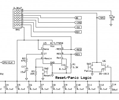

Another option for reset supervisor for less than the cost of the ATTiny13 is the TL7705.
It's got active high and active low resets. It's available in hobby friendly DIP packaging too.
I've used it with the 65C02 and 82C55 PPI.

The internal oscillator runs a funny speed (4.8MHz or 9.6MHz) which might be awkward to scale down to 1MHz. I've never used Atmel chips directly.
I got a PIC16F18313 doing the same kind of thing a while back.
https://github.com/andrew-jacobs/hz-maker
The PIC has a 8MHz clock which can be divide down into 1, 2, 4 or 8Mhz output. It has a numerically controlled oscillator that is used to generate a 1.8432MHz signal for a 6551 ACIA but could produce other baud rate frequencies.

I believe the Atmel chips can take an external clock up to 20MHz and then divide that down more evenly.

I have been thinking about something very similar. Those Atmel parts are very attractive since they work at up to 5v and cost around a dollar.
Looking at the datasheet, I did not find an option to reroute the system clock to one of the pins, so you would have to flip the clock pin yourself with code. With 9.6 MHz as the internal oscillator frequency, so you would have 9-10 cycles to flip the pin and jump back to the beginning of the flip routine. This might just be doable since the AVRs are supposed to have mostly single cycle instructions. I have never tried, though, so I'm not sure. If you want the 20 MHz frequency the datasheet mentions, you need to supply that signal to the chip yourself, since it doesn't have the circuitry to support a crystal.
I have been looking at another chip in that line called the ATtiny2313A, which is $1.36 and comes in DIP20:
http://ww1.microchip.com/downloads/en/D ... oc8246.pdf
On page 27 you can see that it has an 8 MHz internal oscillator that can be divided by 8, which gives you 1 MHz. Page 32 shows that you can output this signal on a pin, so you don't have to execute any code to generate the clock. It can run from an external clock like the ATtiny13 or from a crystal connected directly to the chip. This would let you generate any clock up to 20 MHz depending on the crystal you use if you want to build a faster 6502 system.

So perhaps I skip the ATtiny for clock generation, use a 3.6864 MHz crystal and just divide by 2 for the CPU clock. A little faster than 1 MHz but it would be in lock-step with the UART.
Not sure how important that is, however.
Incidentally, I recommend you use a can oscillator, not a crystal, to generate your clocks.

As others have said, many AVR devices other than the ATtiny13 can get a precise clock with only a crystal and a couple of capacitors such as in this board:
https://github.com/neilstockbridge/6502 ... /master/R1
The ATtiny85 is another part also in DIP8 but with more program memory and peripherals and can use an external crystal (at the expense of losing two pins).
