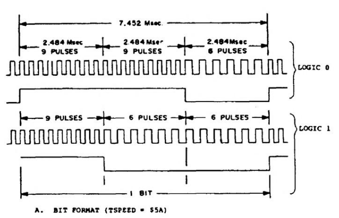

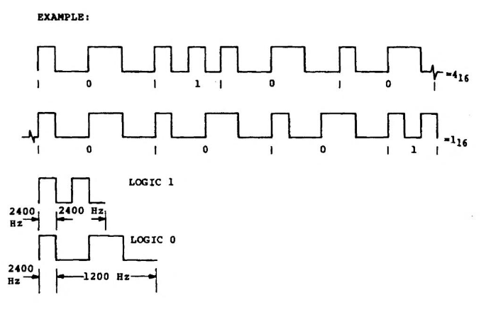

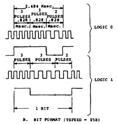

I'd be inclined to tackle the audio tape problem not as an audio problem or a waveform problem but by decoding and re-encoding the waveforms for each bit. This could be more reliable as well as more dense. There's information about the three different low-level formats in the User's Guide which is available here in PDF and here online. (The PDF version is clearer but the online version is OCRed.)
There's also information on the higher-level organisation into checksum-protected blocks and into files. It might be worthwhile to work at the block level.
Here are some images from the manual, of the lowest level.

Well, Chromatix did already explain the problem with MP3° precisely. And thanks to BigEd we don't need to search for information about the tape output signals of an AIM :) - very helpful!
If one would sample the signal directly (no knowledge of its structure) the sample rate needs to be at least 16 Ksps. We have 2400 Hz and there needs to be at least the 3rd harmonic recorded to reconstruct something that looks similar to the original. And then there is Mr. Nyquist so we need 2400x3x2=14400 sps at least. But we also need nearly no amplitude resolution as there are only two different levels. So 16 kbit/s should be sufficient for raw data.
On the other hand a single bit is encoded within ~7,5 ms. That is a data rate of 134 bit/s. In relation to 16 Kbit/s this is 120x less or requires 120x more storage :shock:
The only advantage of dealing with raw samples is that it doesn't matter what kind of source format and encoding is used. Even a KIM or an OSI "tape" should work.
