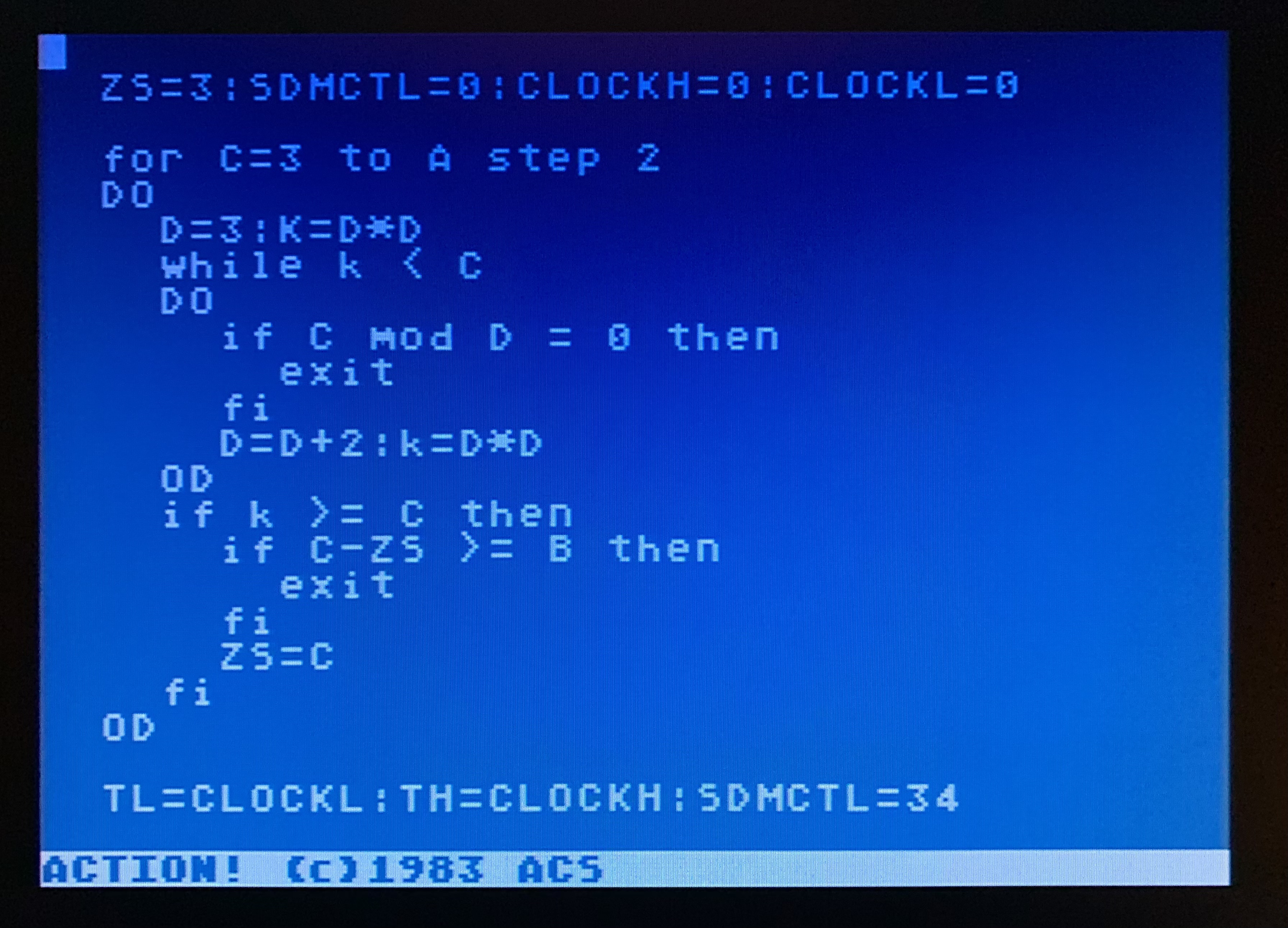

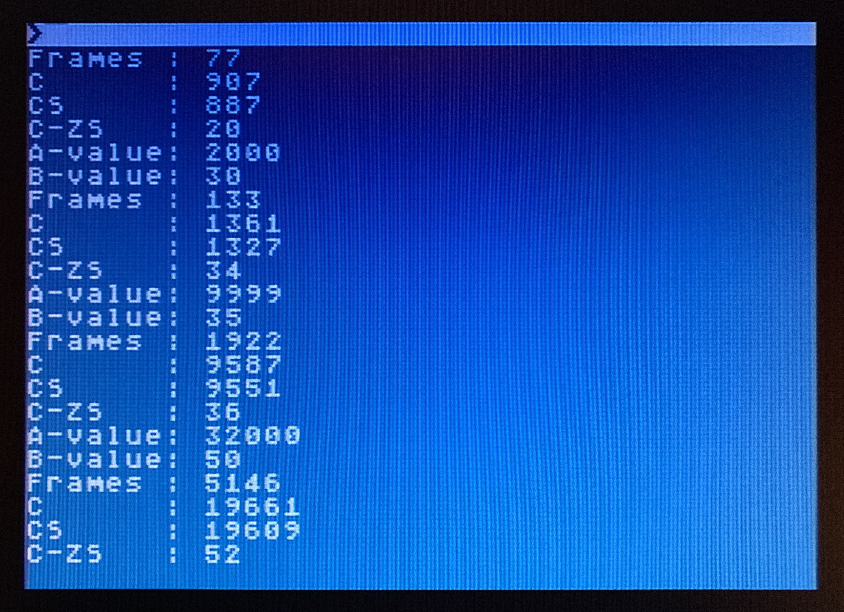

Atari 800 & 800XL:
Straight port of above code into 1983 OSS Action, typed in, compiled and ran on-cartridge:
Results in frames (@59.92 frames/sec), and Antic DMA=OFF (max. 6502 cycles):
Test 1: 1.2850 secs (77 frames)
Test 2: 2.2196 secs (133 frames)
Test 3: 32.0761 secs (1922 frames)
Test 4: 85.8812 secs (5146 frames)
Could have effortlessly attained those results 38 years ago... ;-)
