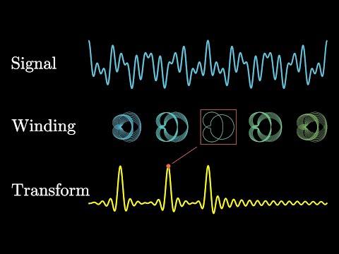

In a similar vein, here's a nice short video explanation of Fourier Analysis, or the relation between the time domain and the frequency domain:
But what is the Fourier Transform? A visual introduction.
