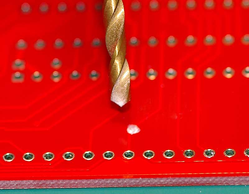

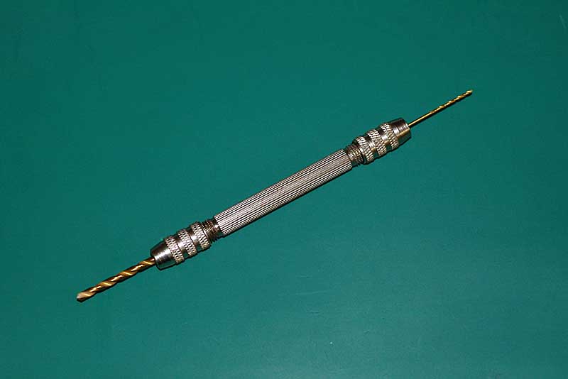

Posts: 1005
cbmeeks wrote:
... PCB traces, etc.
For PCB traces I use a small drill bit in a pin vise. A couple of twists and the trace is cut.

BillO wrote:
I'm an old stick in the mud and continue to use my trusty X-Acto knife for trace-cutting. :roll:
