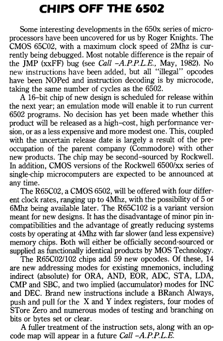

I see from August 82 CALL A.P.P.L.E that a CMOS 6502 was in debug, and that Rockwell would produce chips, and that MOS Technology would be a second source. This is a bit later than I would have guessed.

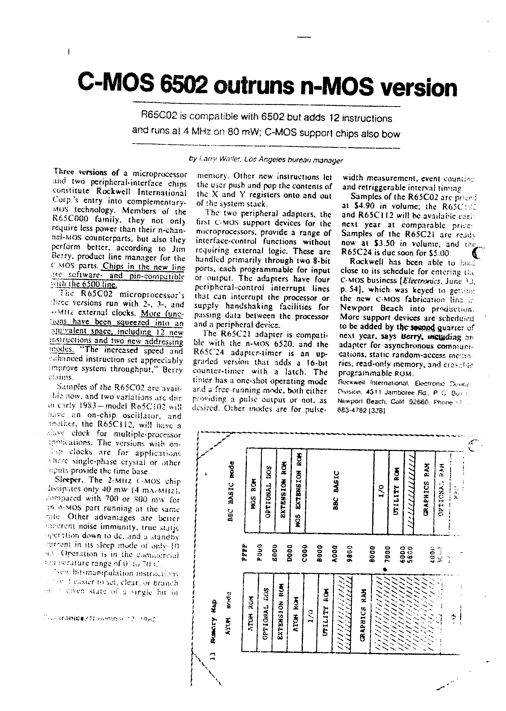

This article reproduced in Atom Nieuws (a Dutch Acorn Atom Newsletter) also suggests samples were available in August 1982:
http://www.acornatom.nl/atom_nieuws/198 ... 828062.htm

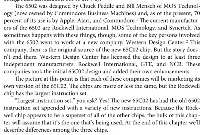

"Southwestern Data Systems Presents the wonderful All New 65C02"
I find it quite interesting as to who did what and when. WDC was founded in '78, apparently. Perhaps Bill Mensch created it so he could offer his design services. Perhaps he offered his services to Rockwell, an existing 6502 licensee, and perhaps he cut a deal to do the design for less money if his company could keep the design data to license elsewhere. I do recall some comment to the effect that MOS aka Commodore agreed to leave WDC alone in exchange for a free license - or something like that.
Also interesting that the 65c02 was not quite finalised but the '816 was already in the works. Feels to me that Rockwell wanted the bitwise instructions, but WDC decided to NOP them out to leave room for compatibility when the '816 came out.
Edit: see here
https://books.google.co.uk/books?id=JjI ... &q&f=false
where it says that WDC did the design, and initially licensed to Rockwell, GTE and NCR. Only Rockwell had the extra instructions.
