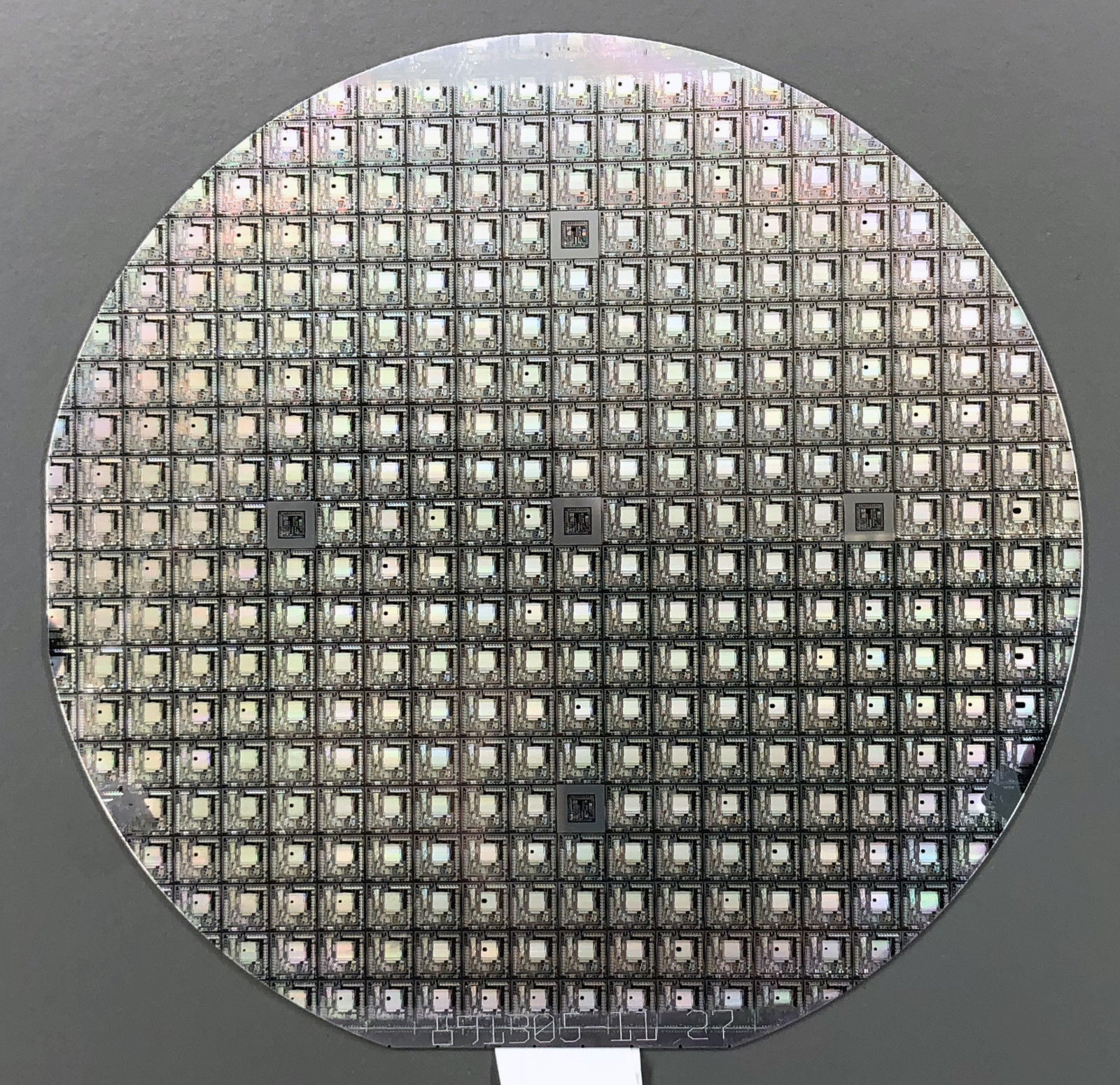

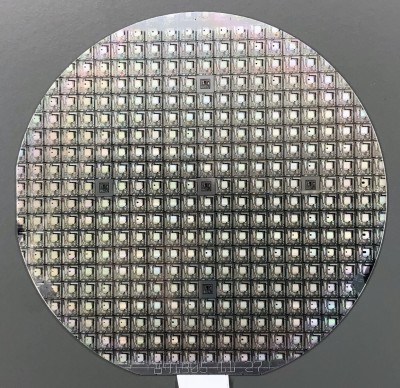

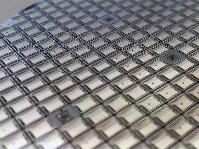

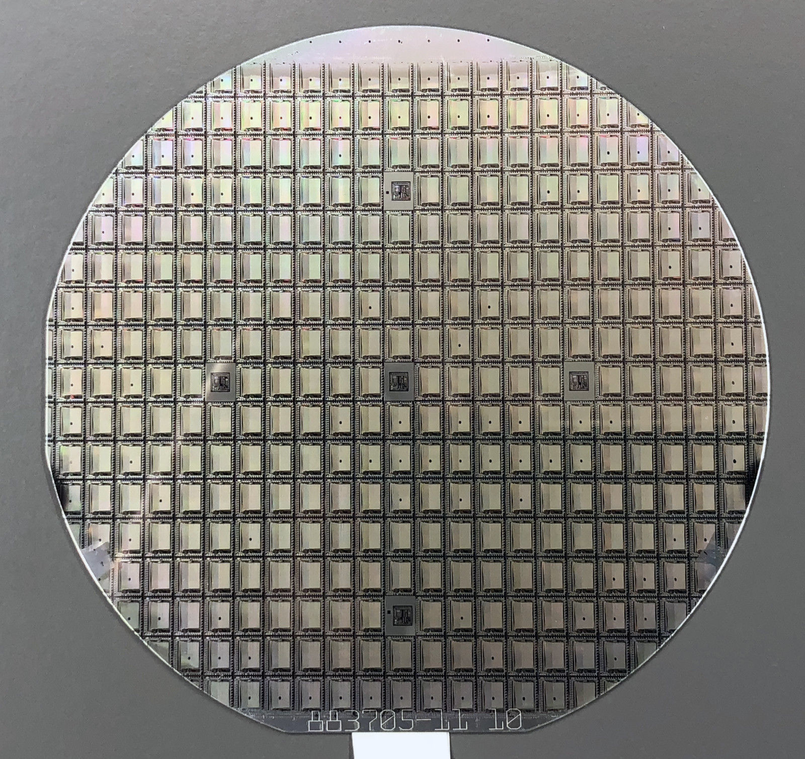

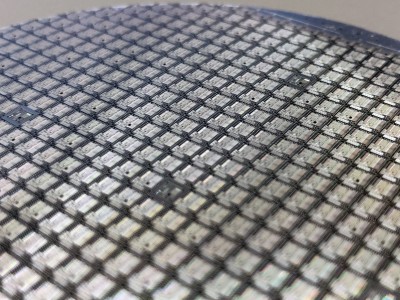

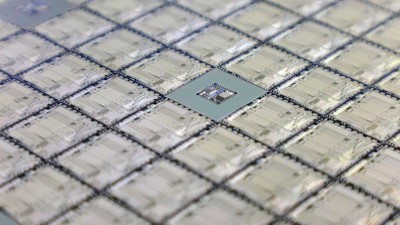

Well, just to follow this up a little bit. I recently bought a 6569R5 wafer from someone on ebay. It is a full 4 inc/100 mm (pick your choice) wafer with 6569R5 chips. I am not sure if some of them are marked (bad ones), so this may have came out from before device testing. There is also 5 smaller chips on it, which are probably a test run of some other component. It looks like it has been decently stored.
The 4 inc wafer is the reason Commodore made very little money. Compared to 6 inc process, 4 inc was much more expensive per chip to run. A contemporary report from Intel shows this really well. Looking at the wafer we can see that its only about 250 chips on them as the 6569 is quite large.
I also include some other wafer pictures from MOS. All made in 1984 or later on 4 inc. In fact, one (dma controller) seems to be an Amiga component used in the A2090 scsi controller which was sold from 1988.
All-in-all this seems to indicate that Commodore stuck to their 4 inc process into the late 1988. Not surprising since they had little money at the time, and it looks like they neither put capital aside to replace the fading 4 inc process.
MOS 6569R5 VIC-II:
File comment: MOS 6569R5 VIC-II
MOS 6525R3 TRI-PORT interface (confirmed by seller that this is not the 6526, but the 6525):
MOS 8721R3 PLA
MOS 8727R3 DMA

Nice! The pads will be scratched if the chips have been tested - probe cards leave marks. But I don't see any ink spots, so probably not.
My feeling is that 6inch wafers came quite late in the day. And of course, did not arrive everywhere at once. And indeed, the capital cost of a new line with all new equipment is enormous - not only do you need to find the money, but you need to be the kind of outfit with an eye to the future returns on that investment. And, to keep a 6 inch fab busy, you need to make a huge number of chips. Probably Commodore were too small volume to do that.

Haha.. well, I could actually do that as I have access to alot of equipment. Including Silicon dicing saw, wirebonders (the thing that attach gold wires to the edge of the chip) ++. Finding the time and need is another matter, and you can still buy 6569 from ebay.. so why destroy an important piece of history for that.
So no, I am actually going to keep it as a wafer. My only regret is not finding earlier 6560 or 6561 wafers. Or even a 6566. :roll:
Well, Intel and TI survived that way.. and they also made chips for others. I guess the ultimate reason was Commodore's owner Gould. He has been described as one that didn't want to loose control of the company, so he would probably not have allow such a huge capital raise... But it remains speculation.
This report though is no speculation: https://www.chiphistory.org/chc_upload/content_inline_files/pdf/industry_overview.pdf
With MOS, Commodore had a large edge over competitors in the early 80'ies. They could force price much lower without loosing money. With Amiga's many custom chips, they had the same edge even without the 68000 cpus. But with a costly 4inc line not being upgraded, that edge would have ultimately gone.. and they eventually bled out.
Another interesting thing (from the other pictures) are the ink spots. The 6525 for example, has a huge number of failed chips. Way lower than the 99.9% required for efficient production. Its slightly amusing, but also a sad fact.

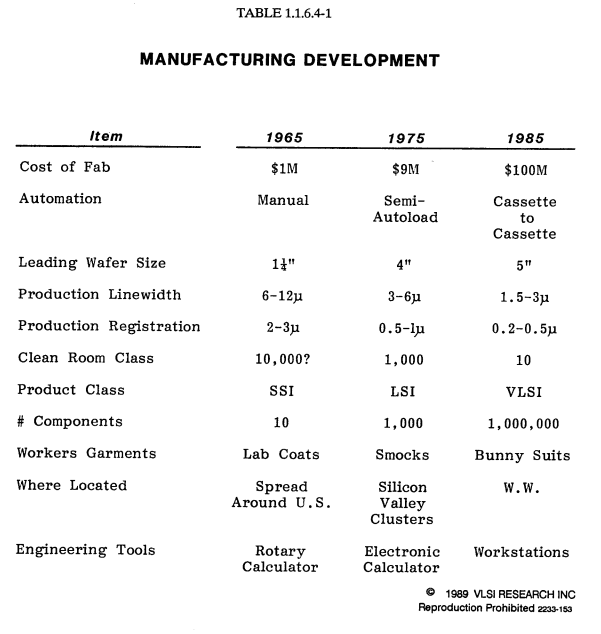

PostPosted: Fri Oct 05, 2018 8:07 am
Nice PDF, thanks! There's a table on page 47 which illustrates the difficulty of justifying a new fab, and a quote that the industry found the transition to 5" wafers "quite difficult" - even in 1989 we see 6" wafers are in the future (oops, no, I misread), and the extrapolated costs are enormous. Also notable in the article, the semiconductor industry ships $66billion of product, of which $40million is in the consumer sector. We see that a company like Commodore is an absolute minnow, and it's an unlikely circumstance, an accident of their history, that they find themselves with a fab of their own at all.
(Earliest) introduction date of each wafer size:
1965 1¼ inch
1974 4 inch
1979 5 inch
1985 6 inch
1987 8 inch
Bill Mensch recollects that Moto, and then MOS, were not yet using 4 inch wafers at the time of the 6502 introduction, and that MOS were getting 100 good die per wafer compared to Moto's 10. (I'd take this with a grain of salt, personally, but I'm sure there's some truth in it.)
