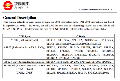

Sunplus SPC81A¤¤ (2000) - 4&6MHz - 69 opcodes(?), 80KB ROM + 128Byte RAM, 2 D/A converters (8-bit), 20-IO ports
¤¤ Sunplus has a full range of controllers that contain 65B02 or 65N02 (Full instruction set), 65R02 (Reduced instruction set) or 65S02 (Reduced instruction set+bit+TAX+TXA). The different controllers are equipped with different amounts of ROM, D/A converters and IO ports. They are often found in toys.
