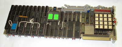

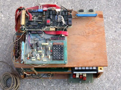

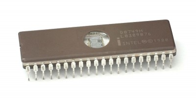

jamesadrian wrote:
There was once 6502 development systems that were fully functional without the involvement of Windows, OS X, Linux, PCs or iMac computers.
Yup. In the early days I used to use my heavily modified KIM-1 before it was succeeded by my KK Computer. Both featured Don Lancaster Cheap Video and lots of 6522 parallel I/O. Both ran FIG Forth, augmented by Bill Ragsdale's RPN 6502 assembler. There was also an MCS-48 assembler which accepted standard Intel syntax (despite being written in Forth). Peripherals included a homebrew Floppy Disk system and a homebrew EPROM / MCS-48 blaster. The 8748 and its MCS-48 siblings were cutting edge at the time -- arguably the world's first microcontrollers, and certainly the first from Intel.
My first microcontroller gig was in 1985 -- four years before I acquired my first 8088 DOS box. :shock:
