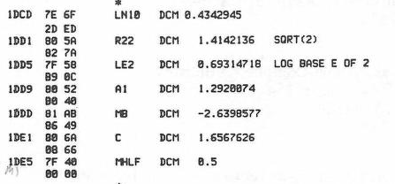

I know this is reviving an ancient thread, I only created an account to search/mention the same mistake, but also the fact that A1 is wrong too:
A1: 80 52 80 40 = 1.289077759
it should be:
A1: 80 52 B0 40 = 1.2920074 as required.
Again, the version at http://www.easy68k.com/paulrsm/6502/WOZFPIA.TXT is correct.
I found this because I wanted to get my head around how to convert numbers to FP representation, and I'm a maths geek so always check other people's working :)

 Post subject: Re: error in wozfp1.txt
PostPosted: Sat Oct 31, 2020 1:51 pm
Thanks for the note! I've fixed both typos, and added a mention of the Errata document too.
http://www.6502.org/source/floats/wozfp1.txt now has:
1DCD  7E 6F     LN10   DCM 0.4342945
      2D ED
1DD1  80 5A     R22    DCM 1.4142136   SQRT(2)
      82 7A
1DD5  7F 58     LE2    DCM 0.69314718  LOG BASE E OF 2
      B9 0C
1DD9  80 52     A1     DCM 1.2920074
      B0 40
1DDD  81 AB     MB     DCM -2.6398577
      86 49
1DE1  80 6A     C      DCM 1.6567626
      08 66
1DE5  7F 40     MHLF   DCM 0.5
      00 00
