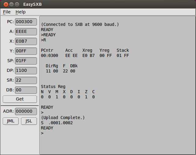

I've only just started this project, but thought I'd throw it out there anyway:
https://github.com/Mortis69/EasySXB
The goal is to have a terminal and some handy utility programs in one package. At the moment the terminal works and you can (slowly) upload a binary to SRAM. Initally planning to support the '265SXB and '134SXB.
A think a lot of the built-in monitor functions can be hidden behind a GUI. It's pretty easy to fake keystrokes into the monitor and parse the results, etc. I still have a lot to learn about these boards though, so suggestions are welcome. Thanks!
PostPosted: Sat Dec 12, 2015 10:38 pm
Joined: Sun Feb 23, 2014 2:43 am
Posts: 78
A little update: The terminal operation is more robust and there are GUI elements for changing registers and jumping to an address. Also fixed program uploading to use the monitor's built-in SREC interface, which should be faster. (Eventually SREC will be supported directly in addition to the Hex format.)
'134SXB arriving in about a week, looking forward to supporting that board also. After that's done I'll try to add Windows support.

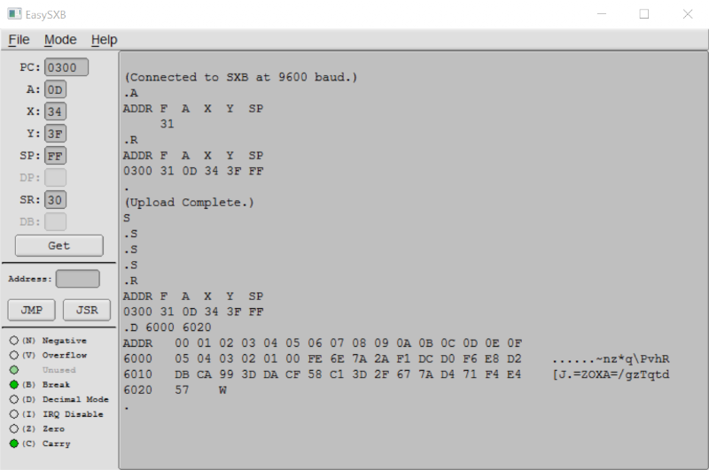

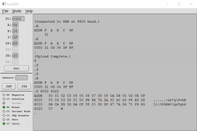

Both the '265SXB and '134SXB are supported now, and its working on Windows as well. (Will get some binaries up after more testing/polishing.)
The gizmos on the left change according to which board you select from the menu. Both have the same feature set:
-get/alter registers
-jump to an address or subroutine
-status register lights (clicking toggles them)
-upload program
The attached screenshot is from Windows 10. Oddly, the '265 worked out of the box, but not the '134 until I installed the latest FTDI driver. So I guess that's important. :mrgreen:

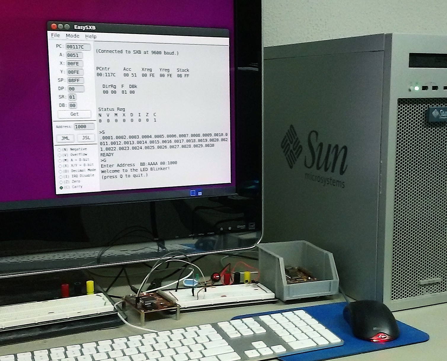

Test setup pic, just for fun:
