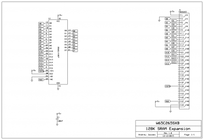

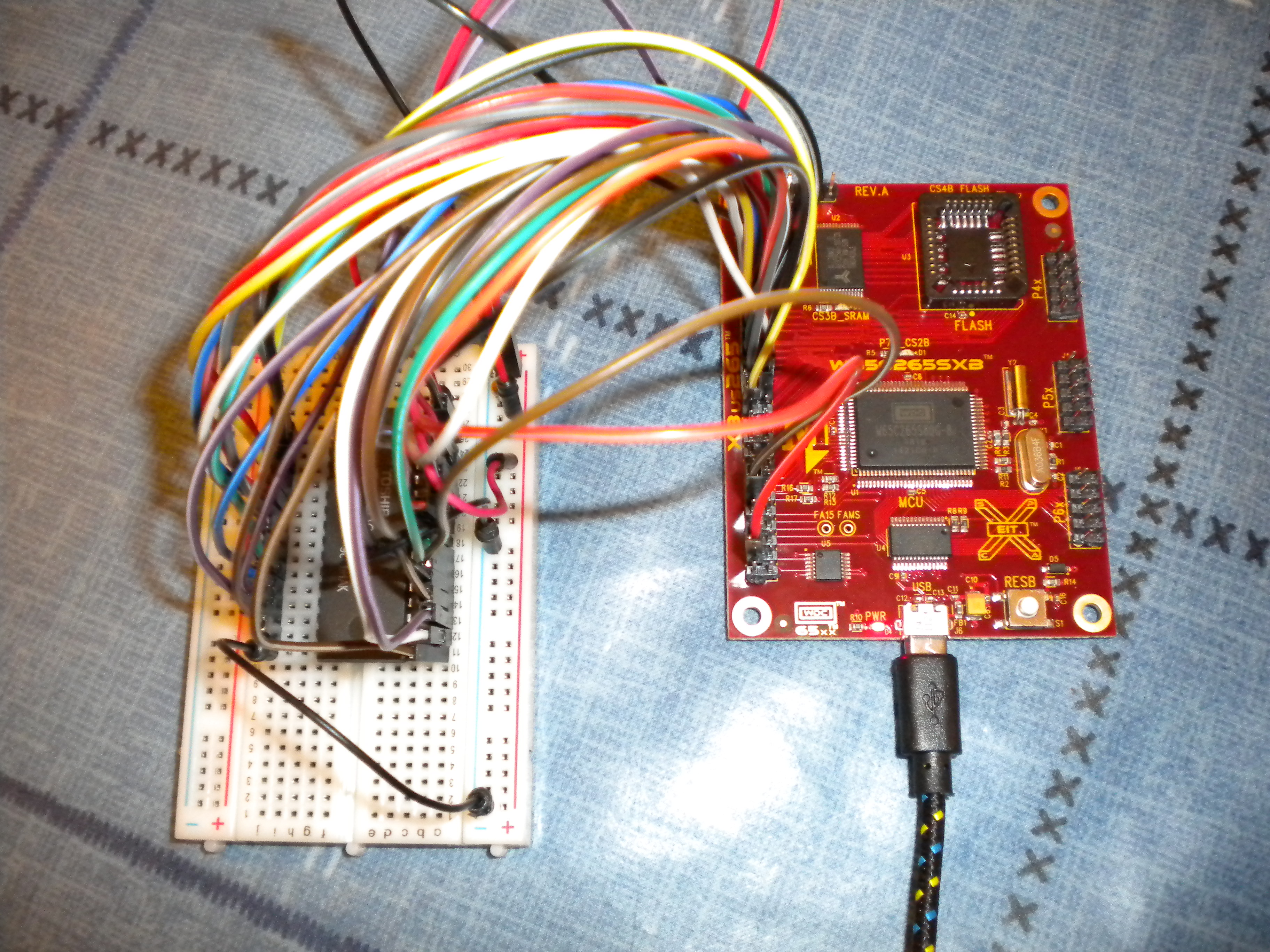

The slower clock speed on the W65C265SXB makes it much easier to play with the hardware. I couldn't find my 512K SRAMs but I did turn up a 128K so I added it using jumper wires and a breadboard. Should be plenty to play with until I locate the bigger chips.
File comment: Loads of wires
This shows the connections.
File comment: 128K SRAM Expansion
I have some spare 128K Flash EEPROMs I got to backup the W65C816SXB firmware so I'm going to populate the empty ROM socket as well.

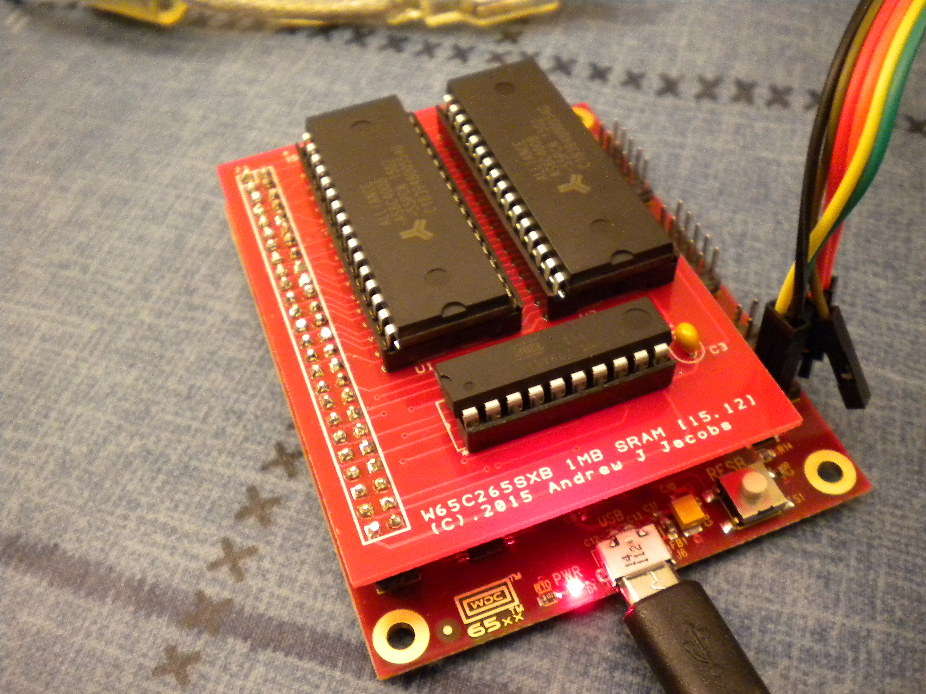

No longer a big mess of wires. 2x 512K of SRAM on a daughter board.

Nice work on the daughter board, I have an EagleCAD schematic and layout for a similar board with 4 x 512KB SRAM and 512KB of flash, but never finished it.
What did you use for layout? I'm curious about positioning of the header, etc.
That board was done with DesignSpark, the free PCB design tool from RS components.
