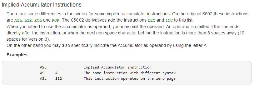

 Post subject: Re: DEC vs DEA
PostPosted: Sun Nov 29, 2015 5:06 am
Posts: 1949
... In an symbolic assembler, however, the operand field may contain a literal address, literal constant, label, symbol or computed value. That's quite a bit different than what goes on in an absolute assembler ...
Please forgive me if I fail to completely understand what is "quite a bit different" ... by my reckoning, there's an operand, or there isn't an operand, regardless of its attributes. San Bergmans made a very nice symbolic assembler that has no problem recognizing a missing operand for a mnemonic that may or may not have an operand. If it sees a naked ASL (or DEC or whatever) it assembles the accumulator mode version and moves on. The only reason that he requires a newline (or a minimum amount of white-space between the naked mnemonic and the remainder of the line) is because he allows trailing non-delimited comments which could cause an attempt to treat the comment as an operand, with undesirable results.
Mike B.
