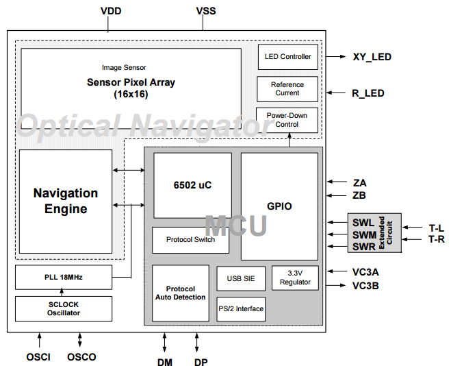

As seen in this datasheet (and similar ones)
http://www.mcuic.com/bookpic/200811516244620817.pdf
we see a 6MHz clock scaled up to 18MHz and a 6502 core together with some hardware to support USB and tracking the optical flow. Looks like the optical sensor is also integrated onto the same chip.
File comment: C1165-011 sensor SoC datasheet
PostPosted: Sun Jun 28, 2015 8:16 pm
Joined: Mon May 25, 2015 1:12 pm
Posts: 92
No mention of any kind of programming sequence? No mention of any program memory for that matter. Intriguing. Besides what it's made for, what could you do with it...
PostPosted: Fri Jul 03, 2015 9:22 am
Posts: 10938
Indeed, unless there are exploitable bugs (as there were in some LCD photo keyrings made with 6502 cores) it's very much a single-use device. I did go so far as to buy a couple of those keyrings, but one had a dud battery and the other didn't work with the exploit code I had, so I returned the pair of them.
PostPosted: Fri Jul 03, 2015 1:14 pm
If it were mounted on a mobile platform, such as a simple robot, it could track the stationary surface underneath in order to provide navigation data. The flip side of that coin is applications where the sensor is stationary but the adjacent medium is in motion.
Admittedly, it's irksome not to be able to tweak and meddle with the 6502 goodness inside! :(
