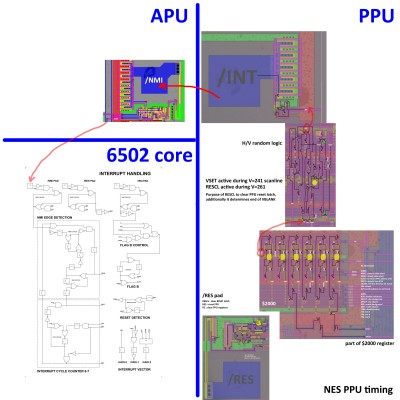

PostPosted: Tue Jun 11, 2013 8:05 am
Posts: 201
Here you go :D
