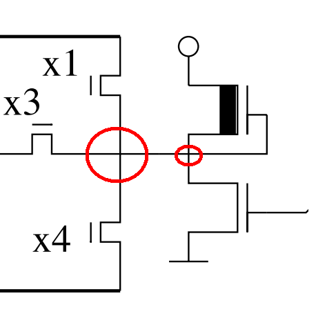

In the following schematic there are two 90° degrees crossings marked with a red circle:
In both cases are the lines electrically connected or do they just cross over without making contact?

There is a connection in both cases: that's the only intepretation which makes sense. Does Balazs generally use solid dots to indicate a connection, or does he generally use little jumps to indicate no connection? Those two conventions are reasonably standard. It's also possible that it's a mistake not to have drawn connection dots.

He uses jumps to indicate no connection. So I will assume no jump implies a connection from now on.

Most of the electrical drafting programs I've used over the years indicate a connection with a dot at the point of intersection. The jump-over seemed to be more common back when most schematics were hand-drawn. I still use it in my sketches, mostly as force of habit.
PostPosted: Thu Jan 31, 2013 6:31 am
I've also seen the convention where a T-junction always means a connection, and a 4-way intersection means no connection.

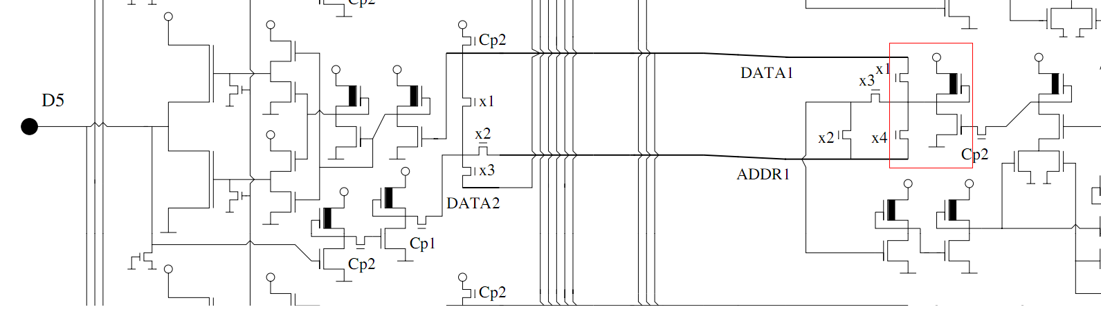

Let me give a bit more context to the image. The red rectangle marks the area where the smaller pic is taken from. It is from the top left part of the 6502 schematic where the data bus is read in(this corresponds to the bottom right part of the visual6502 simulation because the schematic is rotated 180° in relation to the simulation). The same circuit is repeated for every bit D0-D7:
The complete schematic can be obtained here:
http://www.downloads.reactivemicro.com/Public/Electronics/CPU/

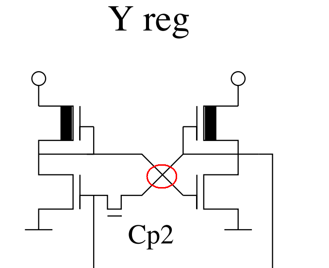

The following is a storage unit from Balasz diagram and the intersecting wires in the red oval do not touch each other(confirmed by visual6502). So the diagram is not totally consistent or maybe it uses the convention that a 4-way intersection means no connection.
Corresponding storage unit in visual6502:
http://www.visual6502.org/JSSim/expert.html?nosim=t&panx=133.3&pany=515.3&zoom=12.8
PostPosted: Wed Feb 06, 2013 7:50 pm
Posts: 10938
Mmm, not totally consistent is the best hypothesis.
