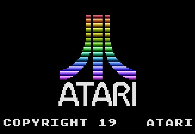

If you peek the IRQ main vector and follow it on Atari 400/800 or Commodore OS ROMs, you'll see that the pointer at [65534] points to somewhere else in ROM which just does a "JMP [534]" (on Atari). There's no CLD being performed. And VBIs/DLIs also don't perform CLDs. They could but they assume no one is doing SEDs in the background or the code is written independent of decimal/binary mode; they restrict code to instructions that doesn't involve the D flag. D flag issue may be the reason why they ended up clearing the D flag on 65c02 processors automatically on interrupts, NMIs, and power up resets. And another reason why the NES variant doesn't even have the decimal mode.
Atari is a 1.79Mhz machine and you can program which scanline to have a NMI occur (display list interrupt) so the picture below shows all 128 colors although graphics mode only allow for maximum of 5 colors. A typical DLI would be like:
1536: PHA
1537: LDA #2 ;color value
1539: STA 53272 ;store color register
1542: LDA 1538 ;modify the code itself
1545: ADC #2
1548: STA 1538
1545: PLA
1546: RTI
So adding a CLD into the above that occur every scanline (15Khz) would use up 2*200 = 400 extra cycles/frame reducing background time.
File comment: Screen shot of Atari 5200 image.
