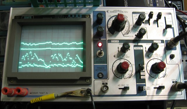

If you like, you could take my definitions there and adapt most of them to STC Forth with no changes.
I did this digital-storage oscilloscope application on my '02 ITC Forth running at 5MHz, taking sets of four analog samples a thousand times per second, to figure out a problem with a switching power supply under a fast-changing load, in high-level Forth, with no assembly language in the ap.  The samples were then played back on a dual-trace analog oscilloscope for viewing:
I'm not too concerned about trying to get Forth's speed to match that of assembly though, because it is super easy to mix assembly into the Forth when necessary.  That might not be so easy on more-complex processors, but it is on the 65's.  As they say, you can get 95% of assembly's performance with only 5% of the code in assembly, provided it's the right 5% (or change the numbers to 90% and 10% if you like—you get the point).  I could have made it sample much, much faster if I wrote a simple sample-taking ISR in assembly language and integrated it with the Forth.  It would integrate seamlessly, and the majority of the code would still be in Forth.  I suspect many people are thinking the assembler is run separately from the Forth compilation, and then the two have to be merged and reconciled somehow.  Not so.  It's all the same environment.
