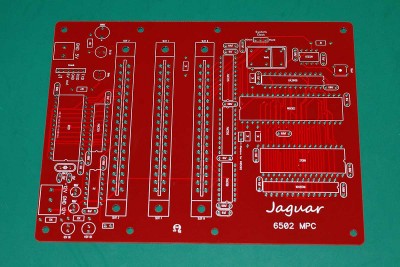

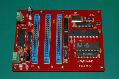

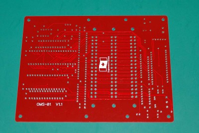

That would be amusing if nothing else. I'm slightly more interested in the 16MHz "Jaguar".
Here it is. What would you like to know about it?

Ooh, now that's a sharp-looking little beast. I don't see a thread for it on the forum here - did you design it? What are the specs, and is there anyplace to get a bare board?
