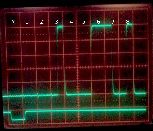

Here we go again, this time with new chinese scope probes and a marker on the other channel to incontrovertible identify the machine cycles. The marker is an unused output of the IO address decoder. The signal shown is bank/data 0.

1 PBR,PC          OpCode
2 PBR,PC+1        AAL
3 0,S             PCH
4 0,S-1           PCL
5 PBR,PC+2        AAH
6 PBR,PC+2        IO
7 PBR,AA+X        New PCL
8 PBR,AA+X+1      New PCH
As can be clearly seen, the op, stack and jump table location accesses bank0. Then the internal op cycle and the following read of the low indirect address goes to bank1, the high indirect is read from bank0. The internal should be PBR and the two indirect parts just MUST be from the same bank.
This MCU does something completely wrong. Almost unbeliveable, but that is what happens. Any explanation?
The supply is perfectly smooth and within tolerances. The only questionable signal is dv/dt at PHI2, but it works for anybody else with just an ordinary driver. I have also tested with a separate 245 output just driving the MCU input with no result.
It feels uneasy not to know what is going on and I'm too curious to just PEA @+5, JMP (ABS,X) and be happy with that.

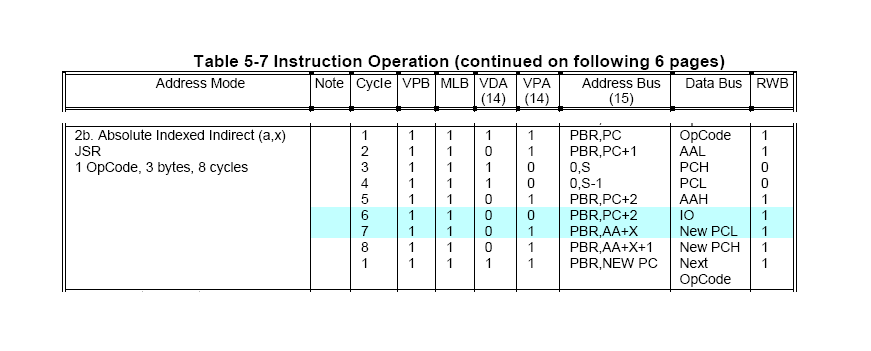

( In case anyone's interested, here's a bit more detail, taken from the November 09, 2018 edition of the W65C816S datasheet. I've highlighted the cyles with the unexpected Bank address. )
