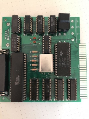

So I've been waiting for things to arrive. In the current circumstances this has been very frustrating with things taking much longer that I thought. I've got most of the parts apart from the bypass caps, two diodes, DB-9 connector and the power connector. The one that I was most worried about was the crystal. It appears to be really hard to get a 1 MHz crystal now. Of course anyone today would be better off with an oscillator, and probably a faster one that 1 MHz, but this is what the TIM-1 suggested schematic had, so I went with it. I also wanted a large one like was used at the time, and designed the PCB with a HC49/U footprint. In the end all I could find was a HC51 crystal (which was also quite expensive). It's just arrived and it is huge, luckily it just fits in the space, but only just.
File comment: Huge Crystal
So back to waiting for parts now. Then see if it goes or blows.

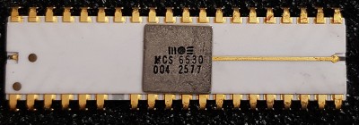

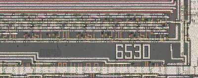

I started reconstructing the 6530-0x and used a "TIM" as victim to be slaughtered and cooked in acid:
See also here:
https://www.patreon.com/posts/tim-had-bath-in-50259557
PostPosted: Wed Apr 21, 2021 8:45 am
That's come out nice and clear. Looks to me like it will be necessary also to remove the metal - would you agree?
PostPosted: Wed Apr 21, 2021 12:08 pm
Posts: 91
Yes... the metal will be etched next week.

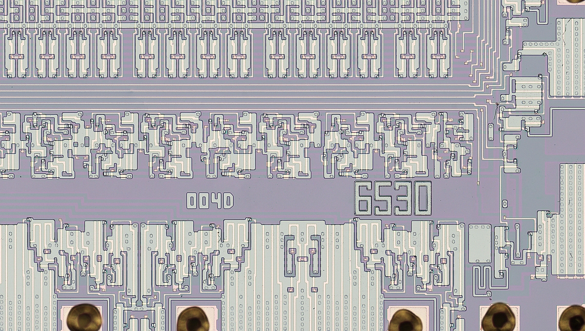

PostPosted: Fri Apr 30, 2021 1:17 pm
Posts: 91
Like this:
