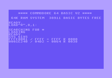

The main part, without the PRINT's, is 107 bytes. It could be made shorter by rewriting using "REPEAT/UNTIL" instead of FOR in the outer loops (FOR loops are complicated, as they need to store the variable address, the STEP, the LIMIT, as you can use arbitrary expressions for those.

I am relieved to see that you corrected the fig-Forth style division bug, per our private discussion a few years ago. Are you the least bit interested in any help making your new divide routine look slightly less "kludgy"?

I certainly noted the issue right away in the code, but corrected it when I ported the instructions to the newest model. I didn't make any of these changes until I fully understood the problem and why/where it was caused, which took a while.

Btw, I didn't mention it before, but hopefully scope-indented asm is something that sticks. ;)
Still haven't incorporated your code, but I did write up a little div test harness. It runs this
.proc test
 mgrow 3
 regnames numlo, numhi, denom
 setp32_w numlo, 4294836225
 setp16_w denom, 65535
 call dodiv
 setp32_w numlo, 123456
 setp16_w denom, 1234
 call dodiv
 retm
.endproc
to output this:
Of course, I made a setp32 instruction just for this, to load a full 32-bit immediate across 2 regs. Because that's how we roll in Acheron-land. ;) I also added the "_w" suffix for a one-line 'with' version. Not sure if the more verbose "_with" would be better, or some other syntax, but when it's used a lot I'm finding it more comfortable to use the combined form directly.
Here's the rest of the support code, which makes native calls to perform the actual character output:
