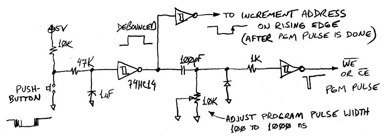

PostPosted: Sun Sep 11, 2011 3:01 am
Just because you have a button does not mean you can't time the pulse to keep if from being low too long. There are plenty of ways to time it. One is what I suggested to Ritesh recently for his manual EEPROM programmer, because the PGM pulse has to be around 350ns long (in spite of the pushbutton):
The Commodore 64 used a 555 timer for this reason (actually half a 556) to make sure the RST\ line did not stay down too long. I seem to remember the Apple II did also, but my Apple II books are not very accessible to check. The Apple II had a reset button, but the C64 did not. The reset circuit I used in my first home-made computer in 1985 used a 555 timer and I think I got the circuit from the Aim-65. Because of the known bug, all these timed it so that the RST\ pulse would be quick even if you hold the button down a long time. On the CMOS 6502 it doesn't matter though. You can hold it down as long as you want.
 Post subject:
PostPosted: Sun Sep 11, 2011 3:47 am
Agreed. In fact I wondered at first whether the 'LS14 in the Microbot implemented a clever little pulse generator more or less like the one in your diagram.
Back to the RST limitation/bug: I just discovered that I was guilty of leaping to an erroneous conclusion. :oops: 555 means pulse, right? Not necessarily! You have to examine the circuit to find out for sure. (See my previous post, which passed yours in transit it seems). The presence of a 555 (or 556) multivibrator, aka "one-shot," doesn't always mean a one-shot pulse is being generated. It's easy to imagine that other people might've made the same mistaken assumption I made.
So, meaning no offense, Garth, but are we sure the Commodore's 555 circuit (and others) actually do limit the RST pulse width? The KIM 556 circuit doesn't. Is there anything else to support this notion of a 6502 CPU bug? If not, I can't help wondering if the RST limitation is some sort of myth or urban legend that has sprung up somehow. Of course I won't mind if I'm proven wrong about that; mainly I just want my curiosity satisfied! :o
