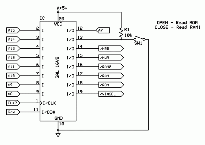

I've been working on some thoughts....
We use a 65C02 with jumper options for a 65C816. We use a TTL OSC for the clock (the user can choose their own desired frequency) and a reset switch (or reset device like the DS1813, etc). Add a pull-up resistor SIP pack for the NMI, IRQ, RESET, BE, etc.
We use three 28 pin DIP sockets for the memory. One could be jumper-enable to support 27256 EPROM or 28356 EEPROM. The other two would be for SRAM0 & SRAM1 (optional). We could also add pads for a .3" wide DIP for the Cypress SRAMS.
If we choose to use the GAL 16V8 for the decoder, here is how I was thinking of using it:
The CLK2 and R/W would be used to decode /MRD & /MWR outputs such that either would only be active during the CLK2 logic high state.
The Address inputs will select RAM0 when A15 is low.
RAM1 or ROM will be selected when A15 is high, based upon the switch input. In either case, RAM1 is written when A15 is high.
The /VIASEL line can be placed anywhere is the address space that we desire... $FExx, $80xx, $7F00, $02xx, etc. The associated RAM or ROM would be deselected for that page. We connect /VIASEL to the /CS2 input on all VIA's and then put A4 in VIA1 CS1, A5 on VIA2 CS1, and A6 on VIA3 CS1.
A7 can either be used for a 4th device, expansion port, or we can decrease the IO space to 128 bytes.
Finally, we provide connectors for the IO pins on VIA1 & VIA2. For VIA3, we place them such that a daughter board could be attached to handle the desired Human Interface.

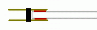

I suggest using standard pin header pads on the board and using the 90 degree pin headers and using standard ribbon cable to tie the boards together. This should prove less expensive than the stackable connectors. You could also provide pads on the top & bottom edge of the board and split a pin header between the board.
Has anyone tried this?
Any comments?

Most printed circuit boards are substantially thinner than the 100 mil spacing between IDC connector pins. You'll invariably end up having to bend pins manually.
Also, I'd rather that the RAM/ROM control pin be controlled electronically. Mechanical switches can bounce, and if the CPU happens to be executing RAM or ROM code at that point, you'll cause the machine to crash. With the transients it might produce, you just might crash it anyway.
I would also suggest "RAM write-through", as was done for the Commodore 64 and 128. That is, to copy ROM into RAM, you just do this:

I will test fit a header on my boards from ExpressPCB when I get home. if it doesn't fit well, then the 90 degree pins might be best.
As far a switching the RAM/ROM, electronic bank switching would be nice, but I was going for simple. my thought was to have some code running in the lower RAM that waits in a loop and prompts the user to toggle the switch now, and press enter when done.
The idea here being to copy ROM to RAM, or download your OS from the host into upper RAM, then switch control once. the ROM could have the code needed and perform the copy down to RAM.
If you have a low-complexity bank switch method, I'm all for using it.
As stated, any write to the upper 32k would be to RAM1, regardless of the switch position. (RAM write through). We could modify that as well... remove the A7 input and replace it with another switch.
We can certainly tweek this. We may even want to look into a GAL 22V10
to carry the bank select logic as well as the address decoding.

kc5tja wrote:
If you intend on running one, and only, one application over the link, that's fine. Otherwise, you're MUCH better off going with TCP/IP. This way, you at least could manage multiple logical connections to the computer (e.g., using a terminal of some kind at the same time as transferring a file). Implementations of TCP/IP are freely available as part of the Contiki operating system, for example, or self-standing via the uIP package.
Wow, a TCP/IP stack for a single-digit MHz, 8 bit CPU. Now I've seen everything :)
I wasn't thinking of making my little box multitask, it seems like overkill for something with less than 64KB of user memory (I may have 2 tiered device drivers, but that's it). The "beauty", if you can call it that, of my idea is that it lets you multiplex a moderately complex UI and binary data transfer over a single cable, and I can access all that from a PC/Mac using a standard-ish app (a terminal emulator) without the overhead of something like an X server. I'm going to assume there's a chip or demo board somewhere that works the same as the USB245, but for ethernet instead of USB. If I used that instead of USB or RS232, how would I access my little box from a PC?

I came up with a system using two 16V8s as shown below.
The first PLD does coarse address decoding for two 32K memory areas (LWR & UPR), zero page (ZP), an I/O page (I/O) and a switchable 4K ROM (ROM).
The second PLD subdivides the I/O page for the two VIAs (VIA & VIB), generates RD/WR signals and a flip-flop controlled ROM enable signal (ENB) which is initialised with a reset and cleared by a write to zero page.
DANGEROUS. I strongly do not recommend this approach, because ROM needs to access zero-page. You might think, "So copy ROM to RAM first." But, why have the ROM at all at this point? Having the ability to use the underlying RAM independently of the ROM is powerful.
I strongly prefer just using a bit from a VIA somewhere. You just can't get any cheaper than that. If that takes away from bits you'd use for other things, then use the VIA's serial port to talk to one or more 74595s, with a single bit to publish the serial data when you're done loading it.
The simplest possible design always fulfills two goals: it communicates intent to the code or schematic reader and it involves the least number of design tradeoffs.

kc5tja wrote:
I opted for this approach (in this design) because I wanted to be able to evict the bootstrap O/S after start up and have a full 64K of RAM for application (except for the I/O page). My boot kernel executes a series of LDA $F000,X STA $F000,X LDA $F100,X STA $F100,X ... instructions in a loop on reset to move to the bootstrap to RAM none of which needs access to zero page so the approach is actually pretty safe. I could have used any page as the trigger but zero page works just fine.
In an earlier post I suggested we could use another processor to take control of the bus and load the O/S into the RAM but this requires more glue logic to gate the control signals which aren't affected the the bus enable signal (and the data/address bus lines on the older rockwell chips). I like the idea and am using it in another design but I had to switch to much bigger PLCC based PLDs to get the number of I/O lines I need.
As for using logic controlled thru one the VIAs, yes you could but you'd also need logic around it to make sure that the ROM is enabled on reset so I not convinced it ends up being any simpler than my two PLD design.
I remembered to test fit my ExpressPCB boards. While there is some play, it looks like you could do it.
Daryl
Why not use a 22V10, decode A15 down to A4, and dedicate one of the blocks to either an internal flip flop or an external one. This way, you have defined control over the bank switching. Using two GALs adds propogation delays, and I'd like to make this thing capable of higher speed (especially since we won't have any slow 65C51's hanging on it.)
