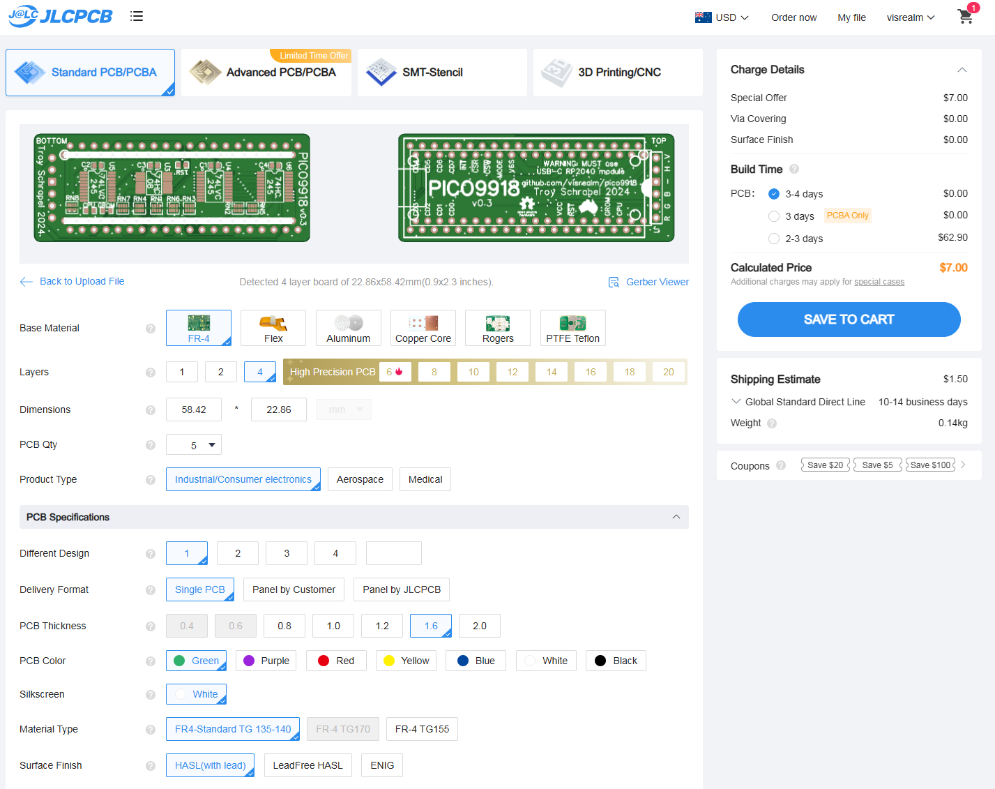

Perfect!
If you're willing to order the PCBs directly from JLC, it will likely be cheaper than I could send you one from Australia:
Otherwise, I could build one up and send to you.

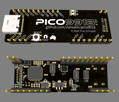

Started working on the next revision of the board (v0.4). The all-in-one.
Looking pretty good. Managed to have it mostly single-sided (good for cheaper PCBA). Most of the components will be on the underside. 4 layers with the middle layers being a solid ground pour and a (mostly) power layer. Signals mostly on the IC layer (bottom) with some on the back (top).
On the top side are a couple of optional LEDs for read and write (for those who like the blinkenlights). The Boot button and USB-C connector required for reprogramming to little RP2040.
Not ordering these yet as I like to give it a few days to "simmer" in case I think of anything I've missed or could do better. Likely order the initial batch next week.

I didn't realize you were all the way down there. :-)
I will see about ordering some PCB's.
PostPosted: Wed Jun 26, 2024 6:35 pm
Posts: 1250
PCB's ordered. It's going to be a while because I got the slow-boat shipping. And, I just realized I don't have some of the SMD parts.

Nice one. I (almost) always get the slow-boat shipping. It's still reasonably quick for the price.
I still don't understand the pricing. I can get boards manufactured and shipped here for less than I can send a similarly sized package within Australia.

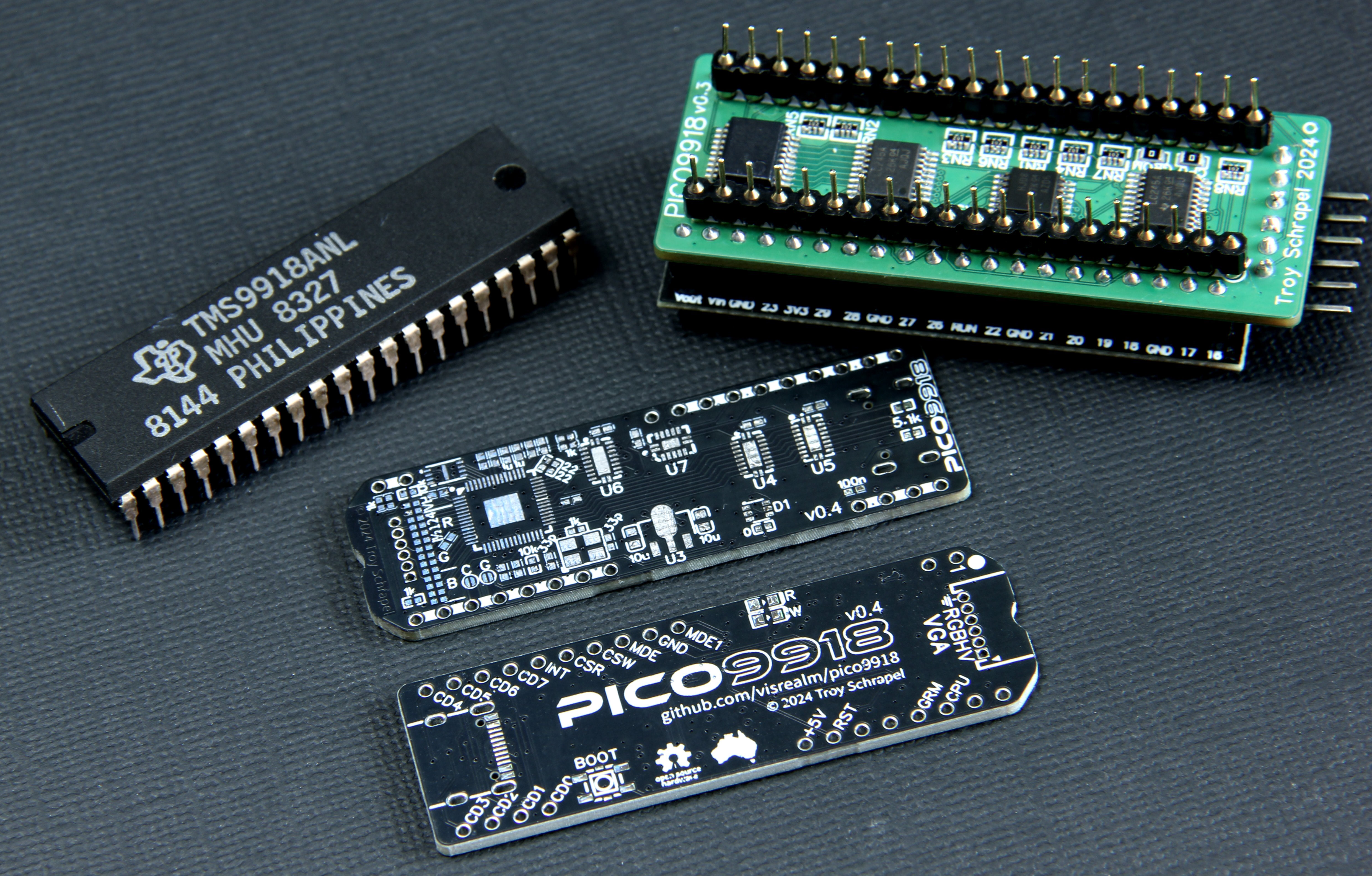

Still waiting on parts to assemble, but the v0.4 PCBs have arrived and look great. Seen here next to their prototype predecessor and an original TMS9918A.
Given this is my first PCB designed to take an RP2040 directly, I wouldn't be surprised if there are issues, but hoping for a usable board. I should have the parts to build one early next week.
