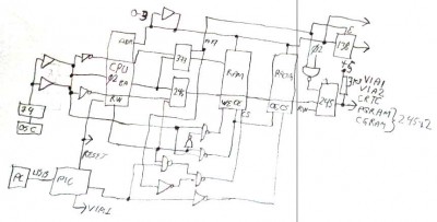

Here is my very ugly schematic. Had to use mobile camera. Scanner failed. Something must have been "upgraded" on my Linux...
The inverters are 74HC04. The triangles without rings are a HC245 channel. A0..A3 are buffered.
The unbuffered addresses only connects to RAM, PROM and video mux HC157.
The buffered addresses also goes to the other chips and mux for PGRAM and raster addresses.
R/W is also buffered, missed that on the drawing.
The parallel buffers on phi2 are a result of testing separate ones for CPU and system. Phi2 goes in parallel to everywhere needed, two VIA's, CRTC and several CMOS gate inputs. All data buffer enable are qualified by phi2. Same goes for read/write of PGRAM and write of write-only CGRAM.

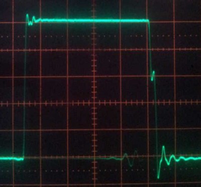

This is a scope photo of BA4. 5VV, 100ns per square. Last calibrated 30 years ago...
Ground tail of course securely connected to the cards ground plane...
There are substantial ringing and overshots, Much more than expected.The 245 and 373 sits alongside the CPU just 7.5mm apart from it. Nothing else are connected to those lines. Top of the leading edge looks strange. Maybe there is some contention?

Hmm, where's the code at $41ff ? (Or is that $ff41 ??)
It's possible your assembler is letting you down: perhaps you could share the listing file?
Can you give an example of where the JSR did land, with the inputs and the code you gave it, in one particular case?
