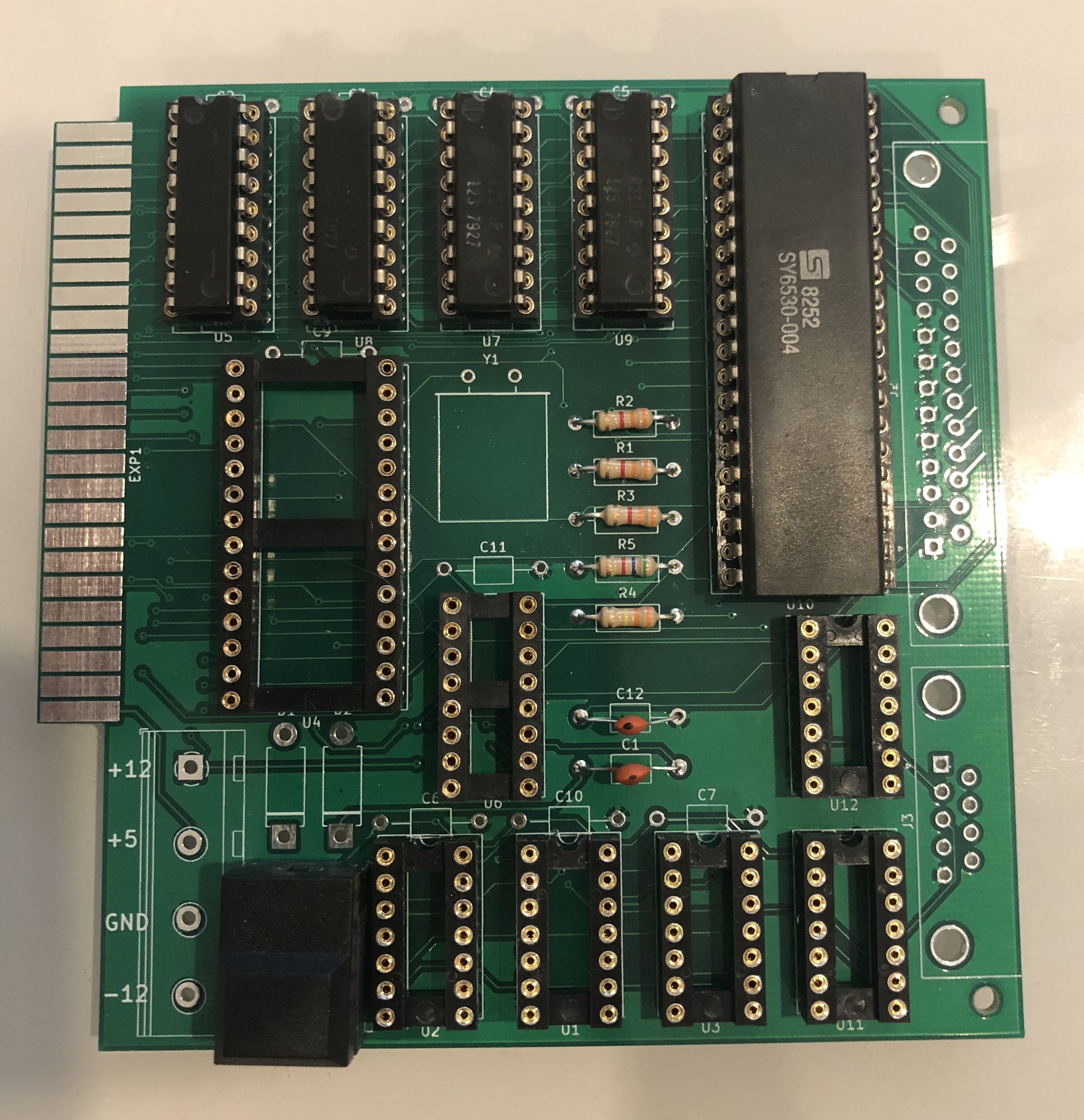

I spent a couple of hours yesterday getting the address decoding sorted out. Cromatix's idea of including a '138 really helped out. In the original schematic there is a 7442 to decode the RAM addresses. This is a BCD to decimal decoder, so quite a creative use to use it for address decoding. It turns out if you fully commit to the '138 it works out really well, I've got everything decoded with no aliases at all, and 3 1k sections decoded on the expansion connector.
I'm planning on putting this board to use with an EPROM programmer card, so the expansion connector will be useful.
For the rest of the schematic I've tried to remain as close to the original suggested design. I've omitted the current loop interface as that's not much use today, and I've hooked up the parallel interface to a DE25 port that should, if I have wired it correctly, interface to a PC parallel connector and allow for data download.
The reset is manually operated, no power on reset here. There are some changes as I've doubled the RAM using 2114's instead of the 2111's in the original design. I've qualified the write on PHI2 as Chromatix points out too, hopefully I've got that right.
There are quite a few unused gates (on the right). This is mainly in the LM1488 and LM1499. They were used more in current loop interface so there is a bit left over. It's a bit wasteful, but it's probably close to what an early 1980's design would do for serial. We have a lot of better options today.
Not sure that basic will fit in this address space, VTL02 looks nice though and seems to meet the size requirements.
The expansion connector will be a card edge connector. It looks like gold is too expensive, but it would look nicer.
This is a first draft of the full schematic, I still have to check it for errors. I'm reasonably confident that the address decode is correct, but I might be tempted to breadboard it just to confirm that it all does work. I hope PDF is an ok format, if not I can convert and upload as something else.

PostPosted: Mon Feb 24, 2020 12:52 pm
Posts: 1005
Looks nice and clean. Using a MAX232 might help simplify your serial implementation (lower chip count, single supply). Unless you are after period specificity, I don't think there would be anything hard in the competition rules against it.
For the qualified write, I think you want the inverter on the R/W signal going into the NAND gate rather than on the output. That way the qualified write will be low when Phi2 is high and R/W is low.

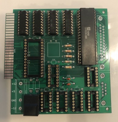

Fitting everything in a 100mm x 100mm board was quite challenging. Looking at it now it looks like there is space left over, but the routing wasn't easy. The expansion connector is based on the Apple II, but with PHI2 added. I'm working on an EEPROM programming board that will hopefully make this a useful device rather than just a historical curiosity.
