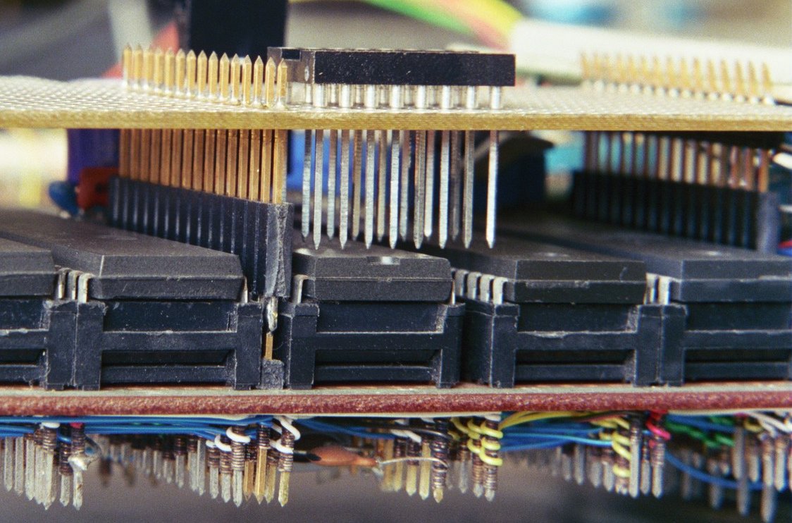

Here's another, for pin headers of .025" square posts with a standard .230" length at one end and longer pins on the other end. I used these for the mezzanine on my workbench computer, both on the mezzanine shown here (before there was anything on it), and down on the main board where the long end of the pins were used for wire-wrapping (between the 40-pin DIP sockets) and I soldered a socket to the shorter end:
The second row is near the right edge of the above picture, and blurry. This following picture shows it slightly better, behind the blue trimmer which is for adjusting the LCD viewing angle:

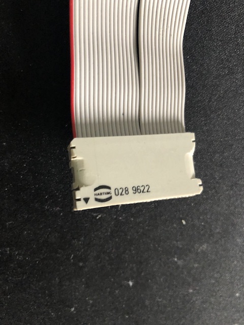

If it turns out that the EJECT-A-DIP is mechanically compatible with a DIP plug, that could be a nice upgrade to keep the DIP plug locked in.
I'm using a DIP plug with the Eject-a-DIP and found that the DIP plug is a little too thick for the socket, I filed some notches in my plug so it'd fit and it works well
