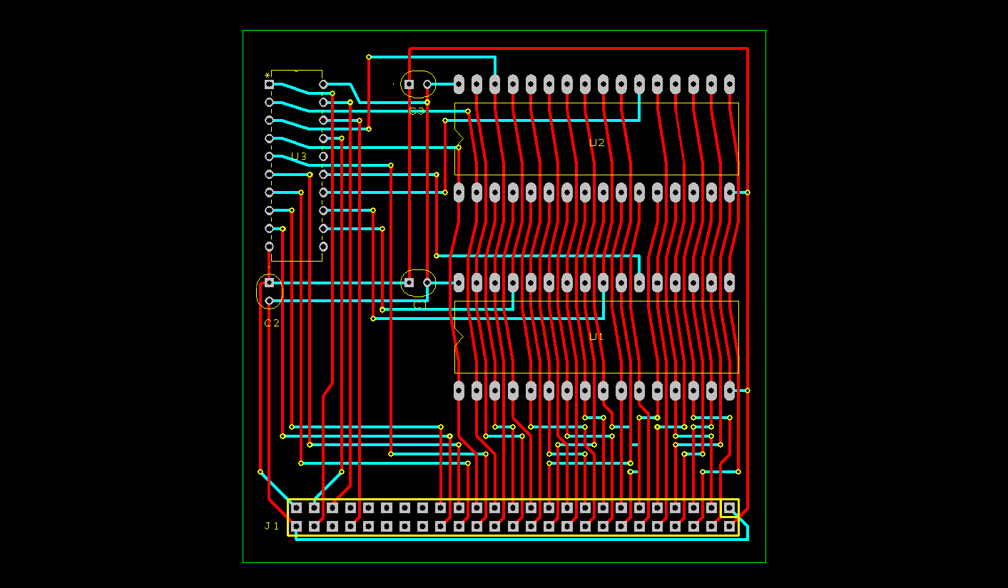

I have design for a 2x512K SRAM board on the XBUS connector resady to send to China for manufacture. I'm thinking of connecting mine to a MMC IDE adapter and an FTDI EVE module with a 5' TFT display via bit bashed SPI from the VIA.

My SRAM board looks like this:

Anyhow, nice board.
Let us know how it works and the Bill of Materials, I might want to make one as well...
