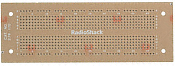

That is a very attractive board for analog! I've used a ton of these Radio Shack 276-170 boards
over the last 25 years for analog circuits since this kind of circuits has a load of resistors and capacitors, and these boards work well; but yours has the following advantages:
  • it's not limited to a single row of ICs like the 276-170 is
  • every other set of strips has six holes per connection instead of five, which would be quite valuable since the 276-170 board with only five often leaves me putting two leads on one hole (if they'll fit), or soldering parts onto the leads of other parts (including onto the tops of IC pins), and parts on the bottom too
  • Yours has both power and ground available next to every 5- or 6-hole connection trace. I usually put copper tape down that area on the 276-170 boards.
There's also the more obvious like that yours has a place to put pin headers and other things, but each of these features is either more suitable for digital work or requires an exact part number like the DC-10 and phone jacks and maybe the pushbutton switches to fit the holes. (I know that's not true of DB-9's.) The digital work is of course what this forum is about, but the digital is often there to control or take data from the analog. I do both, but I generally use wire-wrap for digital breadboarding, and then for analog, I use breadboards that have the rows of connected holes, like yours.

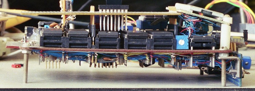

WW boards are more difficult to deal with with respect to mounting, handling and reliability.
The delicate thing about wire-wrap is of course the pins. I put screws through wire-wrap boards to act as feet so the board never rests on the pins.

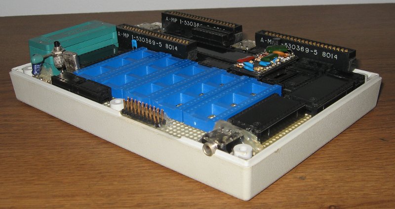

(The above picture was taken when there was nothing on my mezzanine board yet except a 3-level WW socket to show the clearance.) Obviously additional means would have to be taken if you wanted to throw the board in an attache case. That can be accomplished by mounting the board in an ABS plastic box. Even if you only use the bottom of the box and not the top, at least the pins are protected. Here's an example, although I never finished building this one:

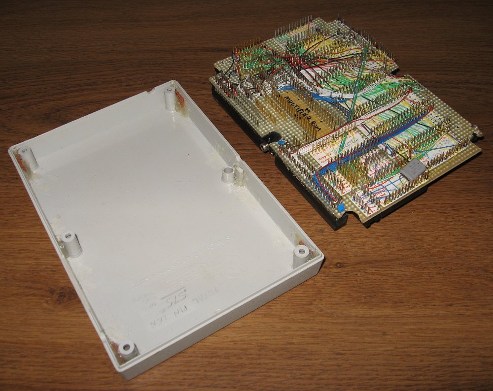

When you take it out of the base of the ABS plastic box, and turn it over, you get:
You can see the pieces glued into the corners and the middle of the sides of the box, to hold the main board up at the right height, making the connectors line up with their holes in the box, and keeping the pins off the bottom. This is one of the computers shown in my (outdated) project pages on this site.
But as for electical integrity, I have never, ever had a wrap fail--not once--and I don't solder them or recommend soldering them. However, I am very careful to avoid touching the sides and corners of the pins, and to strip the wire only seconds before wrapping and then not touch the wire. I don't want any skin oils on either one. I cut the wire the right length so it's snug but not quite pulling the two pins it connects. This makes for the best electrical performance but also prevents unwrapping or snagging.

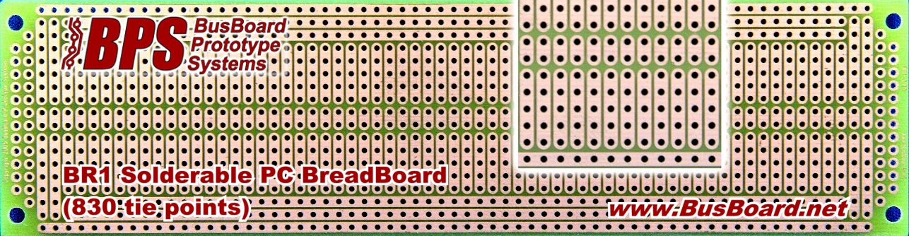

I stumbeled on this http://www.busboard.us/ better alternative to the Radio Shack 276-170 above that I've used so many of over the last 25 years:
Jameco carries it, with catalog number 2125034.
