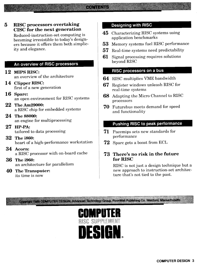

Edit: I just now read several articles in the above Computer Design magazine issue.. Maybe I'll later post a scan the table of contents and one of the articles.[/color]
It's a supplemental issue. It looked like one, but now it's confirmed here. Here's the table of contents:
