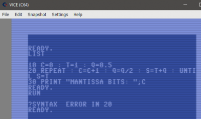

Yeah, I'm having serious difficulty with this. I am pretty sure that CBM BASIC has no REPEAT...UNTIL syntax, and VICE's C64 simulation appears to agree with me:
Well, why "hope" when you can simply post the code you used? And ideally, provide a script that runs the emulator with that code. Even better yet, put it in a repo so that others can clone it and quickly reproduce your results. Unless, of course, you want to make a lot more work for people trying to do the reproduction.
I am really sorry. I have made same simple changes mechanically like an automaton and forgot about them. :(
10 c=0 : t=1 : q=0.5
20 c=c+1 : q=q/2 : s=t+q : if s<>t then 20
30 print "mantissa bits: ";c
40 trap 70
50 c=0 : t=2
60 c=c+1 : q=t : t=t*2 : if q<>t then 60
70 print "max exponent: +";c
80 trap 110
90 c=0 : t=0.5
100 c=c+1 : t=t/2 : if t<>0 then 100
110 print "min exponent: -";c
I think that to publish a lot of code is not a good idea. Especially if the code is almost the same as published above.
BTW the C+4/128 support DO LOOP WHILE UNTIL syntax.
