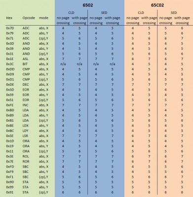

Well,
I ran the Visual6502 this morning using this code:
   *=   $0000
   LDX   #$80
   LDY   #$81
LOOP   LDA   #$21
   ADC   $0080, X
   ADC   $0080, Y
   ADC   ($80), Y
   SED
   JMP   LOOP
0080   .WORD   $0082
0100   .BYTE   $22
0101   .BYTE   $23
0102   .BYTE   $24
The first time through, the ADC instructions used the extra cycle for page crossing, as expected. After the SED and jump, they used the exact same cycles. I thought that if decimal mode was set, these will use an added cycle for any BCD adjust. I even tried it with a carry past 99 but the extra cycle does not appear.
I adjusted X & Y so a page was not crossed and I used 1 less cycle as expected. The BCD math did not add a cycle in this case either.
Am I missing something, or is this a Visual6502 bug?

I think only the 65C02 takes an extra cycle for BCD. It was one of the innovations of the 6502 - the sole patent I think - that it takes no extra cycles for BCD.
PostPosted: Wed Nov 15, 2017 7:25 pm
Posts: 1696
Location: Sacramento, CA
Ok, thanks! The Kowalski simulator is adding 1 cycle for both 6502 and 65C02. More artifacts to document.

I just found these pages in the Tutorials section of this website.
http://www.6502.org/tutorials/6502opcodes.html
http://www.6502.org/tutorials/65c02opcodes.html
They seem to be the best single source that I have found so far. I will use these as a baseline for documenting behavior and then work on the Simulator modifications.
Two notes from the 65C02 tutorial:
JMP (abs, x) appears to add 1 cycle for a page crossing but is not noted
BBR and BBS will add 1 cycle if a page boundary is crossed but is not noted.
Daryl

I just discovered that setting the .opt proc65c02 (or .opt proc6502) statement will allow the assembler to build the proper code, but the Simulator will use the mode set in the Simulator->Options->General menu. In other words, you can have the Simulator set for 6502 and the .opt proc65c02 will build a source that uses 65C02 instructions and when you run the simulator, it works in 6502 mode and treats the 65C02 code as invalid instructions.
If you set the Simulator flag to 65C02 (Simulator->Options->General), it will also assemble using the 65C02 opcode set unless you add the .opt proc6502 statement to force NMOS opcodes.
I have almost finished the modifications to the 1.2.6 source to fix the cycle counting. I will work on verifying the behavior for both 6502 and 65C02 modes.
I am still hoping we can get a more current source to build from.

I've updated the V1.2.6 source to correct the cycle counting for both the 6502 and 65C02, based on as many sources as I could find. I also fixed the Command Log so it would show the disassembled line and resulting registers on the same line. Before, the resulting registers were 1 line below the source. I also added the number of computed cycles for each instruction as well.
It went from this:
1000  A9 90     LDA #$90       A:00 X:00 Y:00 F:20 S:1ff
1002  85 90     STA $90        A:90 X:00 Y:00 F:a0 S:1ff
1004  A9 02     LDA #$02       A:90 X:00 Y:00 F:a0 S:1ff
1006  85 91     STA $91        A:02 X:00 Y:00 F:20 S:1ff
to this:
1000  A9 90     LDA #$90       A:90 X:00 Y:00 F:a0 S:1ff Cycles=2
1002  85 90     STA $90        A:90 X:00 Y:00 F:a0 S:1ff Cycles=3
1004  A9 02     LDA #$02       A:02 X:00 Y:00 F:20 S:1ff Cycles=2
1006  85 91     STA $91        A:02 X:00 Y:00 F:20 S:1ff Cycles=3
Here is a chart of the resulting timing of the instructions that cross page boundaries and/or are affected by the decimal flag:
A black & white pdf version is attached here:
cycle counts.pdf [314.05 KiB]
Downloaded 163 times
I am attaching the modified program, which carries version 1.2.6.1 for now.
6502.zip [539.28 KiB]
Downloaded 151 times
Daryl
For what it's worth, JMP (ind) and JMP (ind,X) also involve possible crossing of page boundaries.
This is wonderful work you're doing, Daryl. Thank you! :)
One other point has to do with 'C02 undefined NOP's. (Unlike undefined NMOS ops these are very simple.) Dunno if it merits your attention, or if the simulator even recognizes them, but some of those instructions *are* occasionally useful (as a trick to avoid coding a BRA instruction). Details here.
