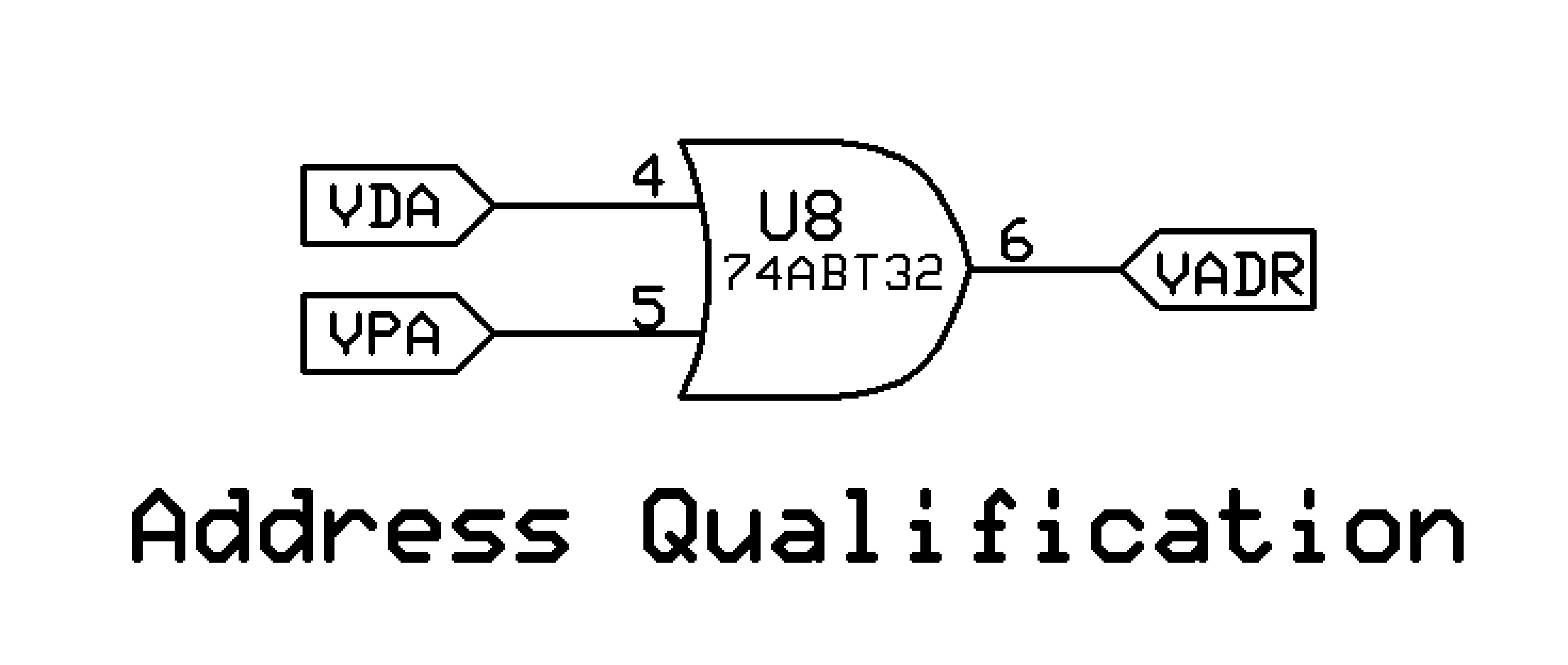

scotws wrote:
After reading about BigDumbDinosaur's problems with a hardware bug ("Unlike the 65C02, the 65C816 can generate false address bus states during the intermediate steps of processing certain instructions."), my enthusiasm is dampened as well.
Yes, the 65C816 can generate false addresses. That's a problem that existed on the NMOS '02 and was fixed on the 'C02. I guess maybe it's easy to get blind-sided by this, but the fix on the '816 takes a different form, namely the VDA signal (which is unique to the '816). The data sheet states,
2.26 Valid Data Address (VDA) and Valid Program Address (VPA)
The Valid Data Address and Valid Program Address output signals indicate valid memory addresses when high and are used for memory or I/O address qualification.
So they do tell ya, but you really need to use your eagle eyes when reading the doc! So it's good to mention this issue.
In reality, use of VDA and VPA is as simple as using an OR or a NOR gate, with VDA and VPA attached to the inputs. When either is high the address bus is valid. It merely means a more fine-grained chip select logic is needed:
File comment: 65C816 Address Qualification
VADR will be high any time the address bus is valid. Nothing to it.
