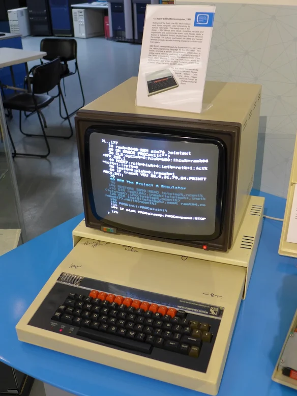

The 808-line Basic model was on display in Cambridge last year - here's a photo:
This Beeb is showing the ARM CPU simulator, famously written in 808 lines of Basic by Steve Furber. It's too small to run it though.
