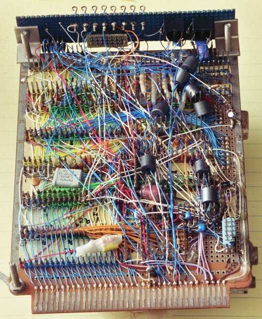

Well, there really isn't much to explain outside of basic math. Let's look at the microprocessor's timing diagrams. When Phi2 goes low, the processor can put the address of the next cycle on the address bus no sooner than 10ns later. If we're working with a 4MHz part, that means that, the rest of the circuitry has only 105ns to respond to that address. Why 105ns?
* With 4MHz, the total CPU access cycle is 250ns. Each half-cycle is, therefore, 125ns.
* The CPU updates the address bus no earlier than 10ns; that leaves us with 115ns.
* A peripheral may require, say, 10ns of setup time before phi2 goes high for proper operation. Therefore, that leaves us with 105ns.
What this is telling us is that your address decoder has to have a propegation delay of 105 ns or less to function correctly. If it does not satisfy this design criteria, the odds of it working out for you are negligable.
Note that during phi2 high, we don't really care about anything, since the magic that occurs during this phase is internal to the peripheral or to the CPU. But some parts must be gated externally (e.g., parts designed for the Intel bus standard, for example, including asynchronous RAMs). Here, the same kind of math applies, but in a different sense. If you RAM has a 70ns access time, for example, you must make sure that your CPU's phi2 high period never falls below 70ns. This implies a 140ns total period maximum, or put another way, about 7MHz. You must also consider propegation delays of the gating logic as well (usually 5ns for the 74ACT00 NAND gate).
And that's the magic, really. It's all just ordinary accounting.

And Garth, I'm sorry if I offended you with my flippant remark about blinkenlights.
Not at all. You brought up a point that we probably need to address in the literature that goes with the board. We won't be delivering a thick book on all the how-to's, but if we can make it concise enough for the newbie to follow, it will help him to see how various things are done.
getting the diagrams of more than 2 or 3 chips to line up, after factoring in propagation delays
If you hold it down to a couple of MHz, you can get away with murder. [Edit: I must clarify that that refers to timings. If you have fast parts, you still have to keep your nose clean regarding build technique, as poor build technique can bite you even at very low clock rates.] The faster you go and the closer you cut the timing margins, the more critical the timing diagrams become.
and trying to wrap my head around transmission line theory so that I can calculate the proper values for the bus terminating resistors I'll need to add.
If you avoid running the processor's own busses off the board and keep the board small with parts right next to each other, you definitely won't need the terminating resistors. This 4.5x6" board
has no power or ground plane, no decoupling capacitors at each IC, and no termination resistors; but the processor's own busses do not go off the board (the boardedge connector is all I/O), the power and ground are distributed from the center in a star configuration, and with 4MHz pars, it gets to 7MHz without problems. Next time I'll definitely use power and ground planes (even for wire wrap), and maybe PLCCs to get parts closer together and get more than one ground pin on each 65xx IC.
I thought googling would help my design, but all it shows me is how unprepared I am.
See my post at viewtopic.php?t=224 in about the middle of the page for links to explanations of all that stuff. I discuss it a little also in the Kestrel 8K topic, starting at viewtopic.php?t=636&start=20 .
