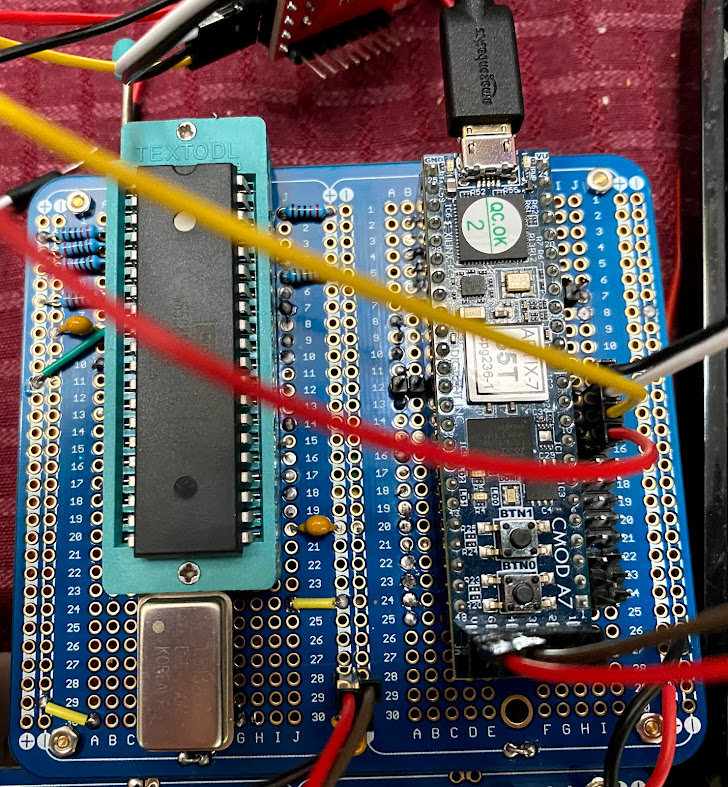

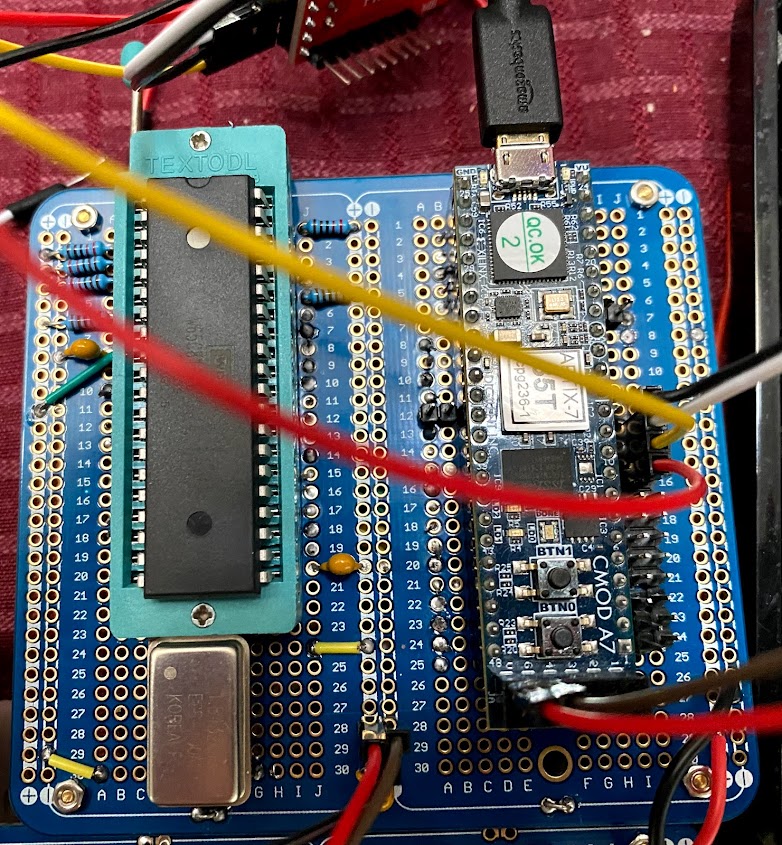

I would start by upgrading your use of supply bypass capacitors, reconsidering how many are present and the manner in which they're connected. Due to its multiplexed data bus the '816 can generate a lot more supply noise than the '02 or 'C02, and supply noise is a plausible cause of intermittent failures such as the ones you describe.

I'll check that out! I just don't know how many more caps I can add, or where.

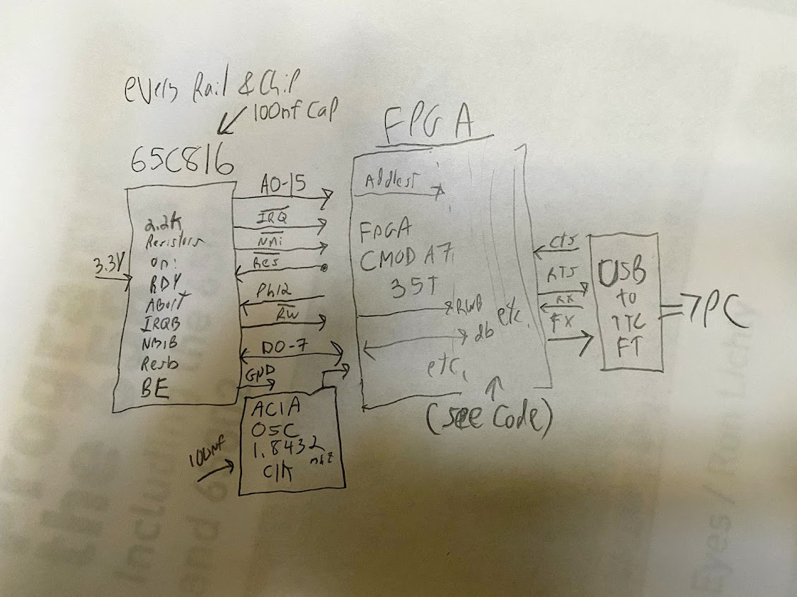

LOL, yes and yes! :lol:
I'm going to just draw it out and take a pic. What kind of pic files can we attach to posts? JPG? I want to keep it on-site.

Okay, this is the best I can do - I am an awful artist :oops:
Connections: https://photos.google.com/u/2/share/AF1QipM1BPMjKumR_siFSWqlkTik-T303uN3s1Gt12JGhWNUjX1JeWQdzOpDRnCW4SYbyQ/photo/AF1QipM3kkbXPFaw5sbKCmqKh6_FrGan1Wq_eoqwU2Ws?key=MEEyV0kxR1JZT0xkVklickNfR19jZFRMZmxFOERn
Picture: https://photos.google.com/u/2/share/AF1QipM1BPMjKumR_siFSWqlkTik-T303uN3s1Gt12JGhWNUjX1JeWQdzOpDRnCW4SYbyQ/photo/AF1QipO6FI3ZtHr8mEpYf9uOckjpJosUARLtAKpuwCIE?key=MEEyV0kxR1JZT0xkVklickNfR19jZFRMZmxFOERn
The pics show the caps - except that the oscillator has it on the bottom.
Jonathan

Also, a FULL schematic would be a BIG help. You can't expect anyone to troubleshoot a circuit if they haven't a clue about how it's hooked up.

How's this? I'm pretty new to this, still, and my fine motor skills stink

File comment: Setup Pic
File comment: My Attempted Schematic

I'm willing to believe you're trying, but you need to try harder. For example your schematic shows an ACIA but the photo shows none, or even a possible site for one. What's the explanation?? And can we see the underside of that board, please?
Going back to general principles, I hope you know the 816's pinout doesn't entirely match that of the 'C02. So, your remark in the lead post about swapping out the 65c02 for a 65c816 leaves me wondering. Are there some jumpers you adjust when you make the swap?
Regarding the HDL code you posted: does your FPGA float the data bus to high impedance when Phi2 is low? The '816 requires this, but the '02 does not.

Regarding the HDL code you posted: does your FPGA put the data bus to high impedance when Phi2 is low? The '816 requires this, but the '02 does not.
That is the clock for the ACIA. The ACIA is a "soft" RTL core, written by LIV2. That clock is used exclusively by said ACIA.

In the lead post you said, "I've been tinkering and testing with my ACIAs (65c51 and LIV2's RTL equivalent)," which sounds as if you meant a real, physical 65c51 as well as the soft core.
Edit: I see you've posted again, but my advice remains the same. Please consider what I said about the '816 needing its data bus NOT to be driven during Phi2 low, as ignoring this detail would cause supply noise which might be the cause of your trouble. I have no further advice to offer at this time -- gonna shut down the screens and get out into the sunshine. :)
